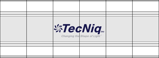

This is 48" tall frosted plus 6" stripes above and below. So originally this was a ~25' glass wall with 48" glass panes with mullions between. So I'd have to install in sections, but wouldn't have any big pcs. So I quoted. I'm using Arlon 5200 2 mil cast.
Then they said there were no mullions, just 1/4" gaps between (now 49") panes. So I figured I'd install a 4x8 center section plus 4 foot sections otherwise and trim between the windows, plus 1/8" margin.
Now they tell me there are no gaps between the panes, that they are touching.
So do I need to install a 4'x25' piece now??
Will either Rapid-Tac or RT2 give me enough working time to mess around with this big sheet?
Do I need to premask now? I was going to just float everything into place when they were little pieces.
Should I slit the vinyl at the window seams? If the panes are out of plane I'd have to but otherwise I don't know whether I should.
Oh yeah, I have also found out that the customers (2 engineers) are nitpicky controlling micromanager types :(
Billct2
I think you have to have a discussion with these guys, the job has changed and gotten much more difficult.
I also think you should cut it at the seams which will give you some breathing room anyhow.

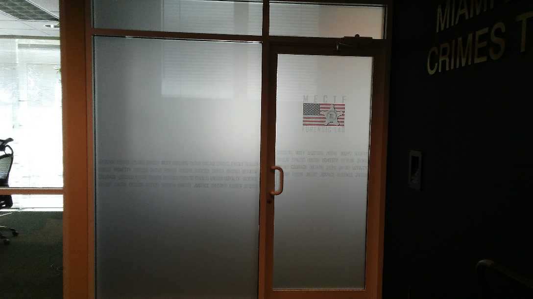

why wasn't an onsite pre-inspection and site survey done before quoting? this would avoid a lot of pitfalls. see photo. client provided sizes and design BUT never realized they would end up with misaligned text.
