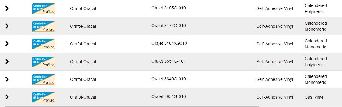

Start with the HP Media Solutions Locator site. It is accessed from the printer's front panel, or a computer browser. There are a number of Orafol/ Oracal medias there, but I don't believe that 3651 was there the last time I checked. It is a calendared polymeric vinyl, and there are several similar Oracal films available to be downloaded to the printer (either model). If a PC accessed the OMS, you will to push the data over to the printer via the EWS. Once the media has been installed on the printer itself, run Color Calibration on the media, from the front panel of the printer. It takes about 10 inches of media, and takes about 10 minutes to complete. This entire process takes roughly 15 minutes. Once the RIP synchronizes the media name and ICC, you should be good to go.
