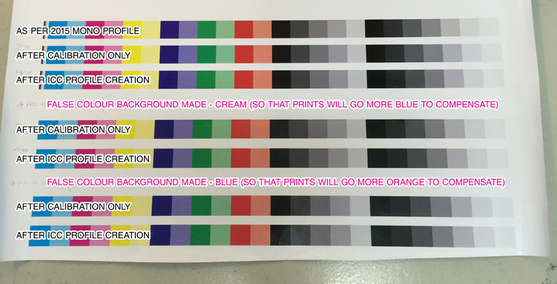

Well the mystery deepens. It appears as if the calibrations are doing something, just not what's expected.
Once again, printed the first test strip with 2015's profile. Then did new calibration & new ICC profile to see if it did anything. It did, but if anything the calibration it took it more to the purple. The ICC then took it about half way back to how it was. Stupid.
Then for the test to see if doing a calibration on a different media, then printing on the first one, would show a difference. For this, instead of using two medias with slightly different white points, I decided to print some dummy areas of cream (to force the colours to compensate and print more blue), and then on a light blue (to force a dramatic shift back the other direction). The results are not what I expected.
As you can see, the colour blocks aren't subtle:
attachment.php
And here are the results. Printed top to bottom:
attachment.php
As you can see there's bugger-all difference. If anything a slight shift in the opposite direction to what you'd expect. My conclusions are:
* Maybe before it starts printing, the head does a quick scan of the white-point of the media. It then processes it in comparison to the white-point of the previous calibration and compensates (which might explain why it actually went in the opposite direction than expected, as the white points are dramatically different). Would it me able to process that in the 10-15 seconds it takes before it starts printing? Or does it process on-the-fly?
* The spectrometer is malfunctioning and only working sporadically. And the only reason the colours were core correct when I made a brand new media preset was either blind luck that the spec worked on that occasion, or maybe the default values are just spot on for that media.
* Reality is crumbling.
