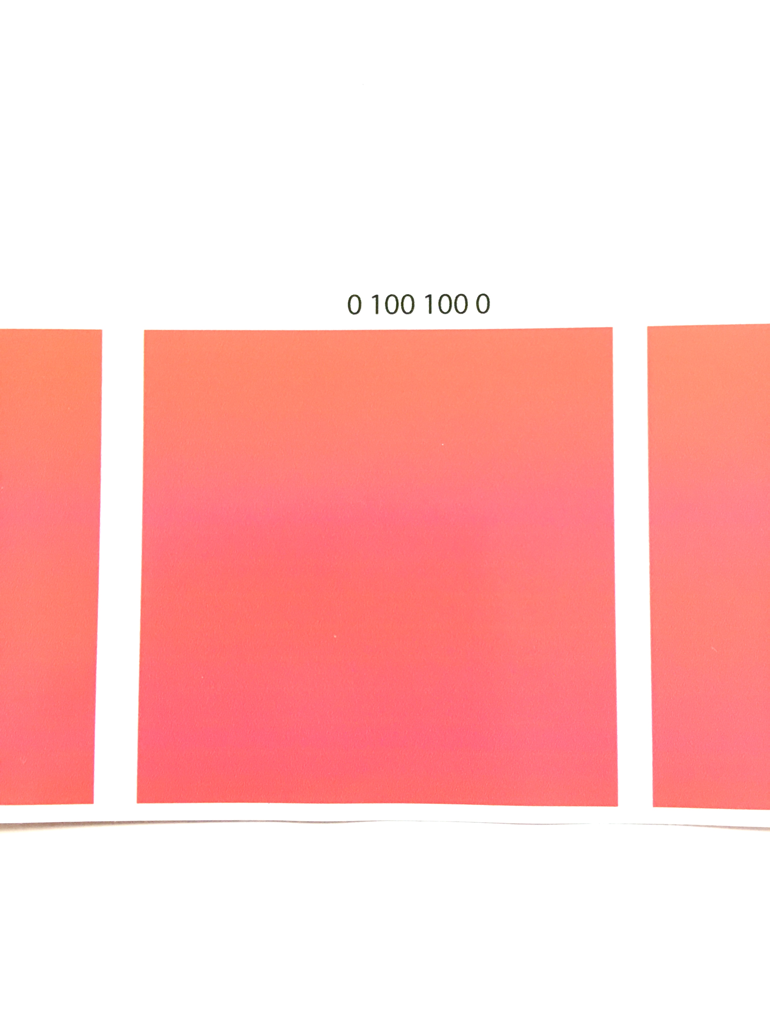

Need Help Latex 370 reds fading in and out.
Any ideas or suggestions to fix.
Our HP latex 370 seems to fade in and out when we printing reds. see attached photo (edited to view beer on screen)
MikePro
assuming your test print is firing 100%, then it seems like ink starvation. try pulling out your ink cartridge and give it a jiggle, if it feels empty then it probably is lower than it is registering within the machine.
