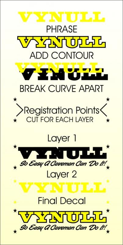

In Corel, this is how I do it.
I won't dazzle you with terms like kerning or welding or converting to curves.
You can use any shape you like for the registration points, I prefer something with corners to help me line them up.
Remove the registration points afterwards, unless you want your layout to look really fancy.
And don't pre-assemble the layers.
I put the first one down dry and use Rapid Tac on the subsequent layers.
Love....Jill
