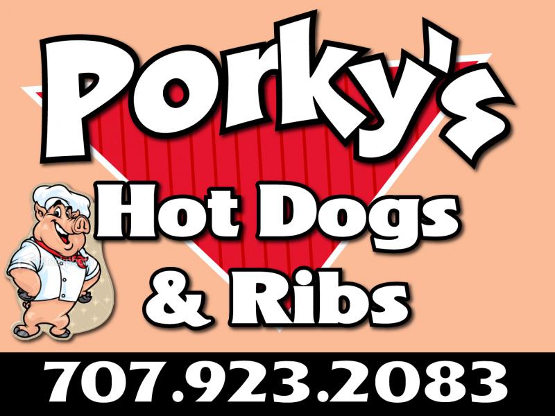

Just curious to see what serious sign designers think of this magnetic Im about to send in to porky. Hope you don't think its a waste of your time.
bob
Find a better pig if you can. Regardless, make the pig larger so that it impinges on the text and becomes part of the thing. Right now it's a disembodied head floating there.
The try to do something else with the copy. You've got the entire space filled to the gunwales with text. No breathing room, no charm. It looks like every other sign of this sort.
Pat Whatley
Shouldn't Porkys be PORKY'S?
Other than that I agree with Bob. Right now it's just a bunch of elements tossed on a sign (and it's not bad, just typical) Enlarge the pig and use it to tie everything together.

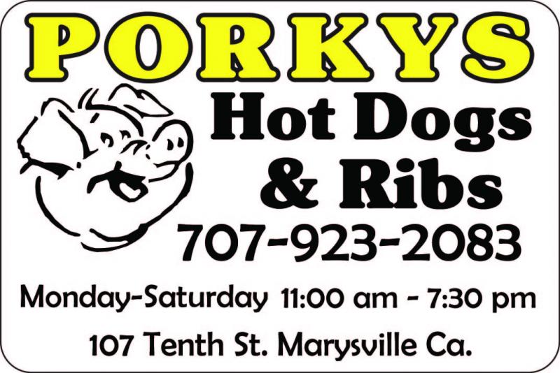

I got some inspiration from the old shagnasty thread. The pig-chef is from istock.
Artildawn
I kind of like Charlie's, but think the cut-out should follow the contour of the pig chef rather than some random part of the back ground. Hours are missing and I'd personally kern the dot separators in the phone number up and centered between the numbers.
trik
Hey Garrett, I like Charlie's as well, but you are probably going to have to put the address on there as well, as the 707 area code is not local, and I would never call it thinking it is in Fairfield or Vacaville.....He is getting a local number? Or going to use his cell? Might want to express that to him?
Again welcome!!

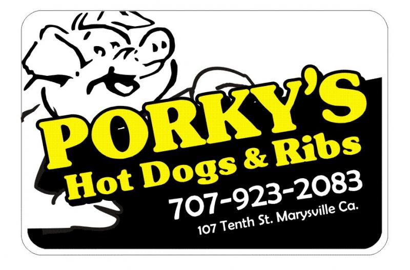

Using your layout just changed things a up little :Big Laugh
Might try a black panel with yellow Porkeys & Dogs and Ribs
