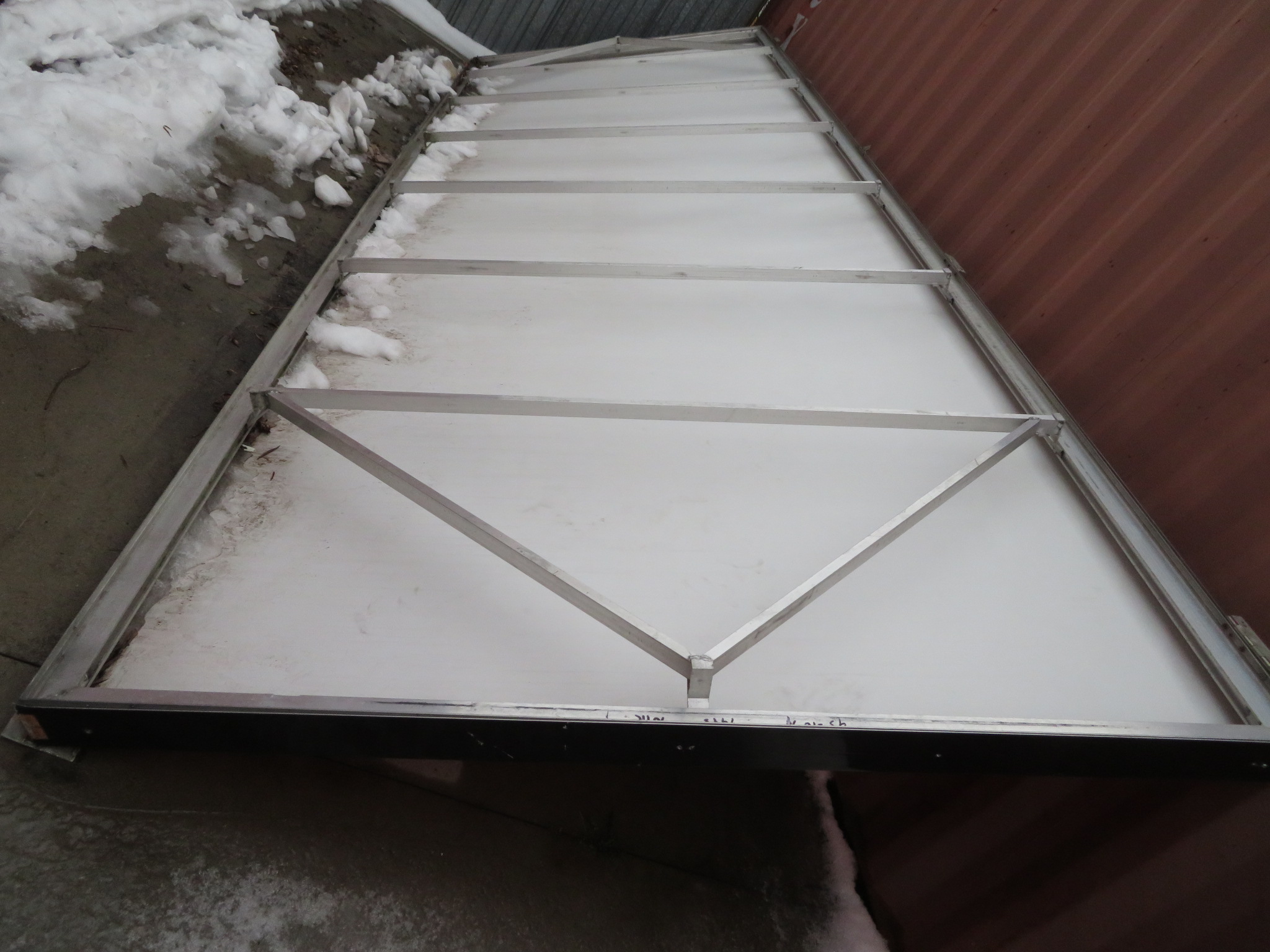

Hi - refurbishing some large flexface illuminated sign boxes with LED upgrade & new faces - they were previously lit by 72" flourescent lamps on 12' centres - concerned about shadowing on the face from the support arms (see pic) for the removable flex face frame if we simply mount LED modules to the back of the sign cabinets
Options A - would be to replace the existing 72" flourescent tubes with LED tubes (I've seen them at shows etc) but no idea who makes/sells them
Option B - would be to mount aluminum composite on the back of the support arms and mount LED modules there
Anyways if anyone has any ideas for recommended components or any sort of tips & tricks that would be appreciated
Thanks!
Sheldon

Grimco Handley LED's & Power Supplys or another brand might work good too. We use the Handley PF-3120W LED's and Handley Power Supplys. You can mount them just about anyway you want. On a single sided sign we mount them to the backside of the cabinet.
On Double sided signs we make our own simple metal strips and mount them in the center of the cabinet and stick the LED's to both sides of the strips then add a drop of silicone to each LED connecting
it to the metal strip in case the VHB tape on the back of the LED's fail. And also important is not overloading the power supplys with too many LED's on each power supply.
And we mount the Power supplys to the sides inside the cabinet instead of the bottom of the cabinet to keep as much moisture away from the power supplys as possible.
