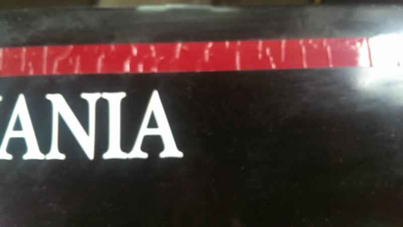

I am working on some stall guards. These are made of thick flexible vinyl. I have used Oracal 751, but a couple of weeks later, everything is wrinkling up. Any other products up there that might be better for this type of substrate.

Are you sure they're flexible vinyl? If they're a low energy plastic such as polyethylene, then you may have to flame treat it before applying an adhesive film.
Billct2
Agree, probably not vinyl. Flame treating or one of the vinyls made for dirt bikes may be a solution. I'd get to the supplier of them.
