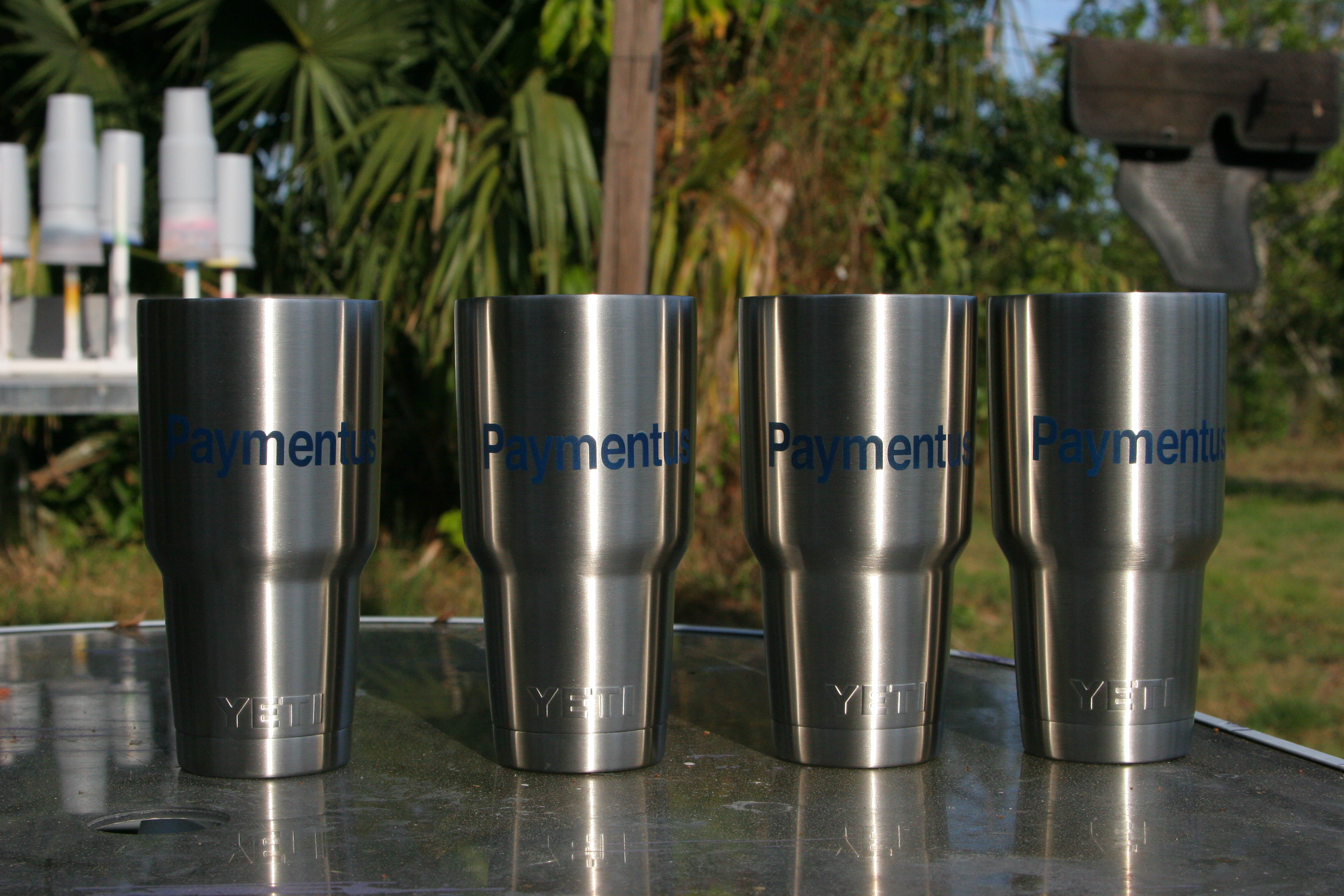

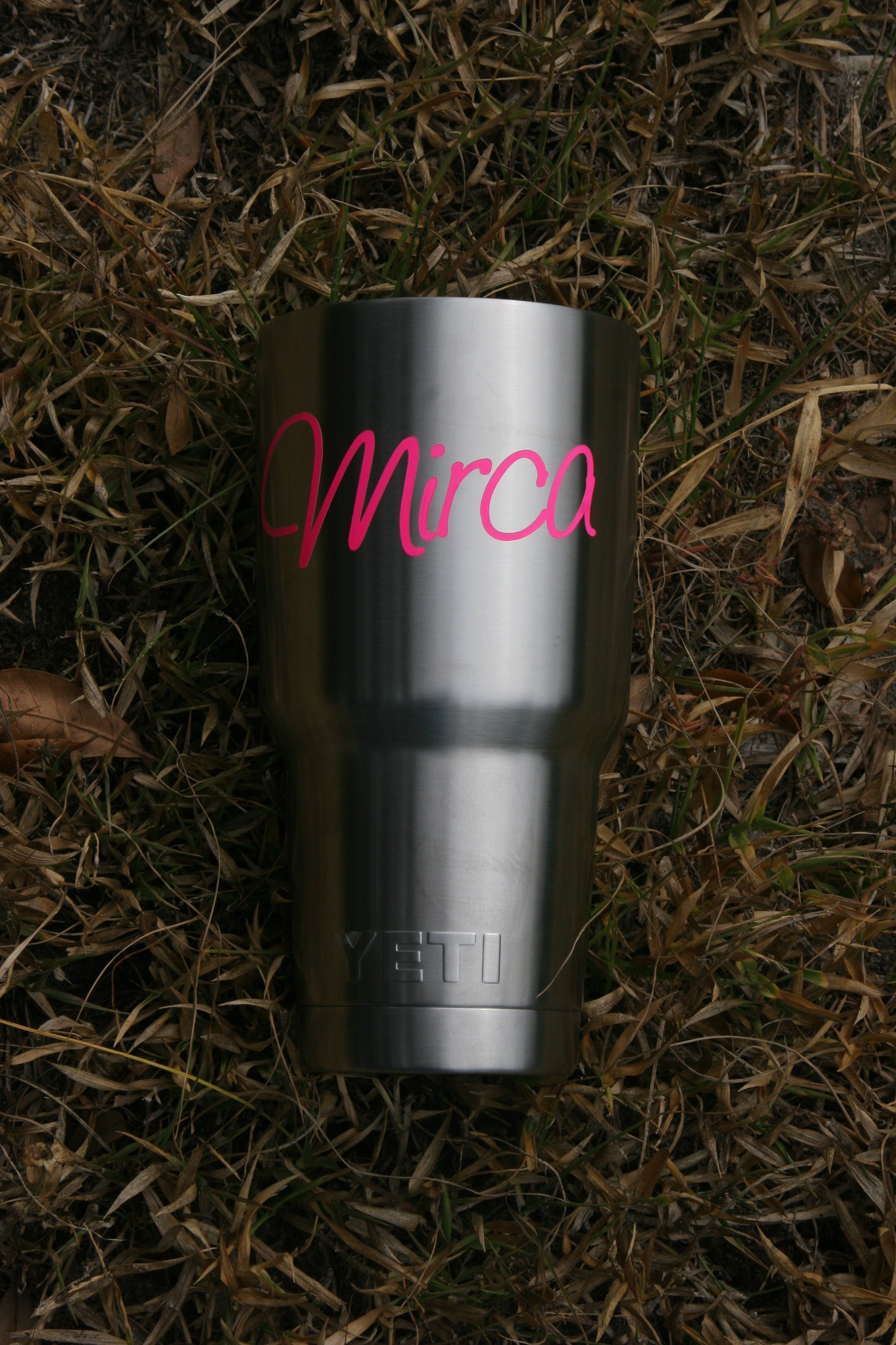

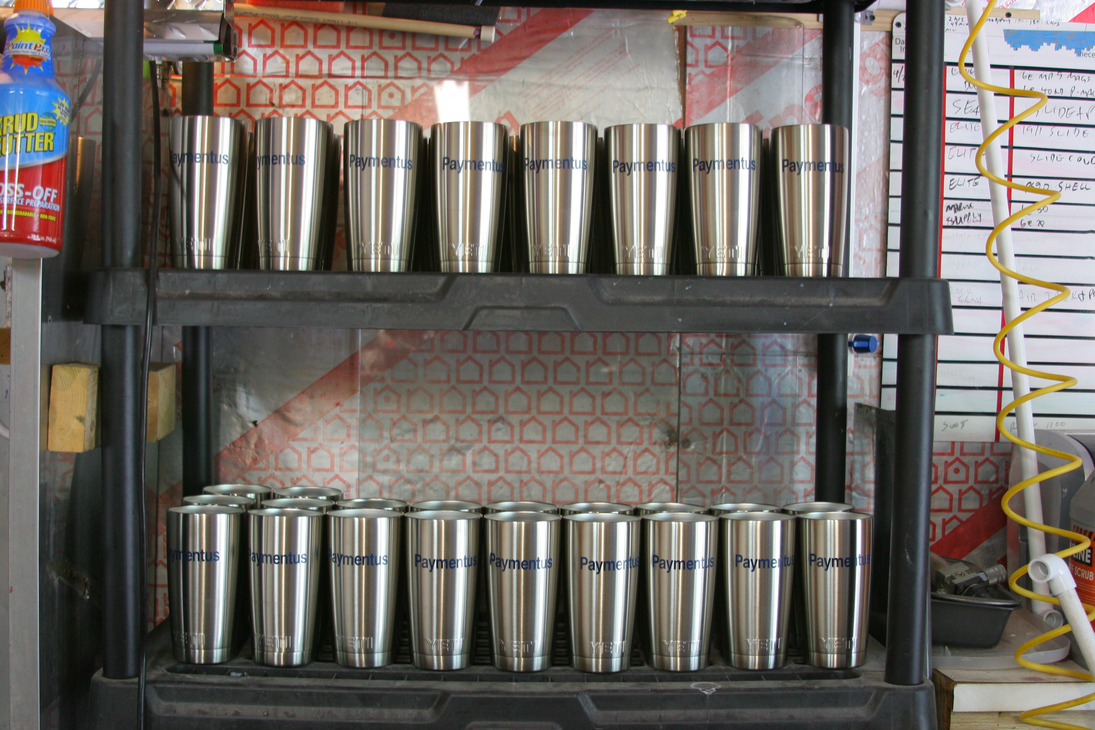

cut a mask, sandblast, apply GunKote, bake. I've done literally thousands of tumblers over the last 5-6 years with this method and a few others. Really depends on what image you're wanting to put on them as to the best method to apply. Vinyl is only temporary.
