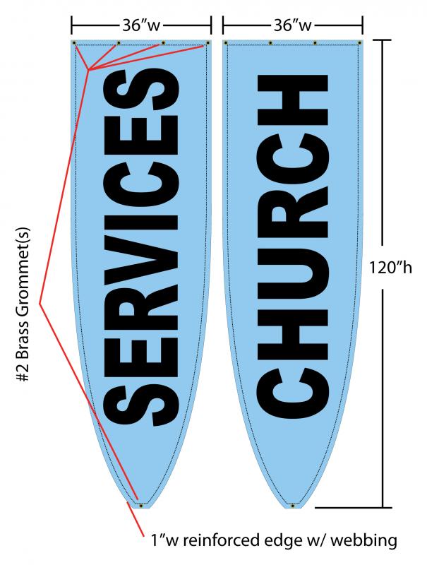

Has anybody had any experience with applying lettering or graphics onto
Dacron Sail Cloth. My client wants to have lettering applied to this fabric.
