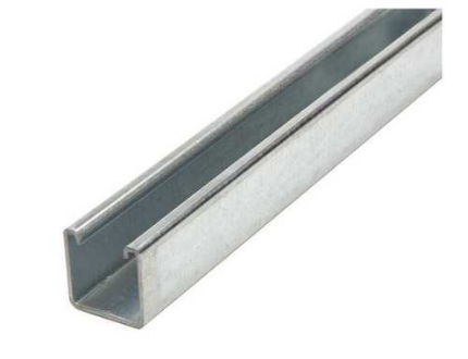

Unistrut is a U shaped channel from which very heavy things can be hung
