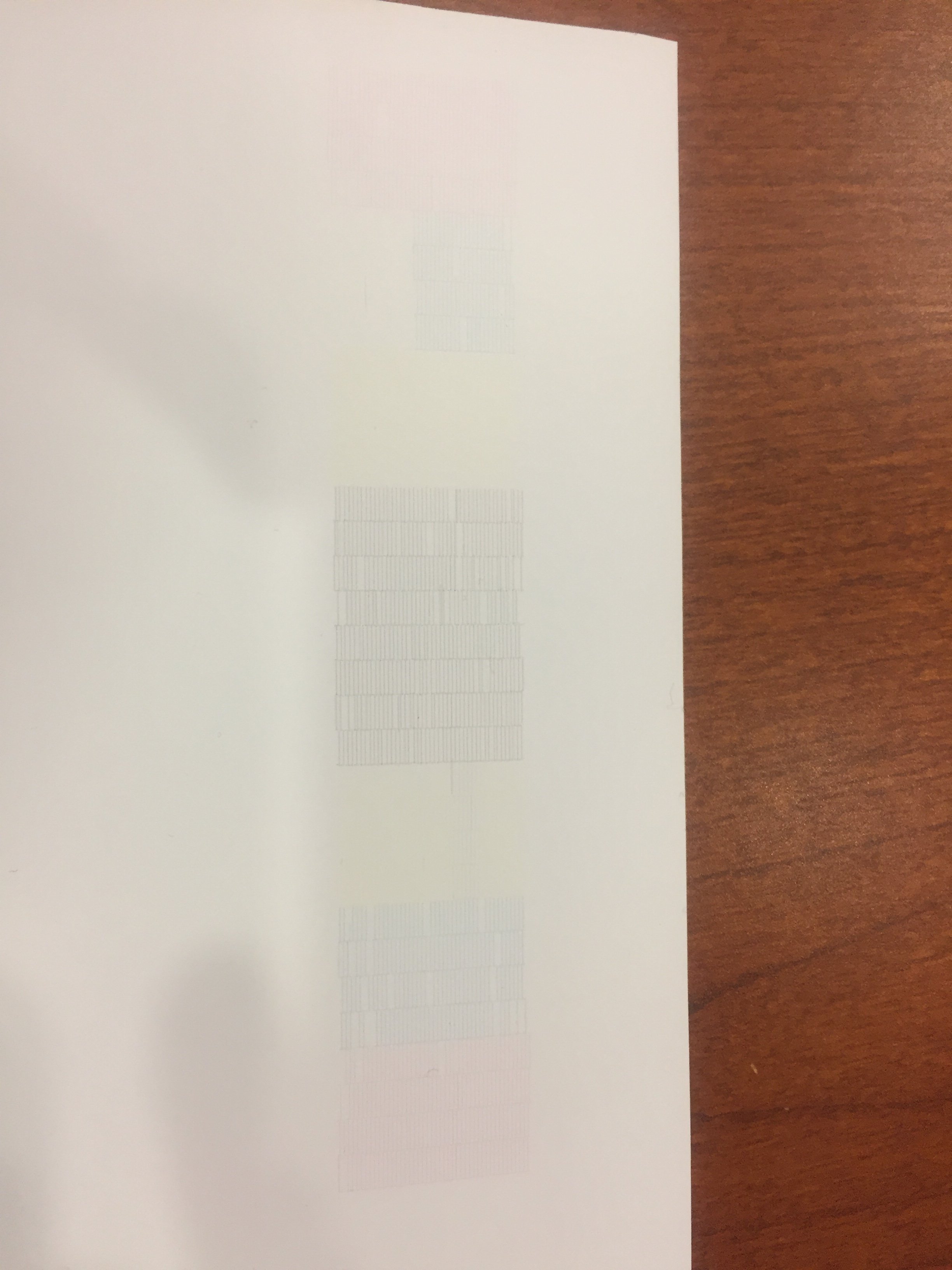

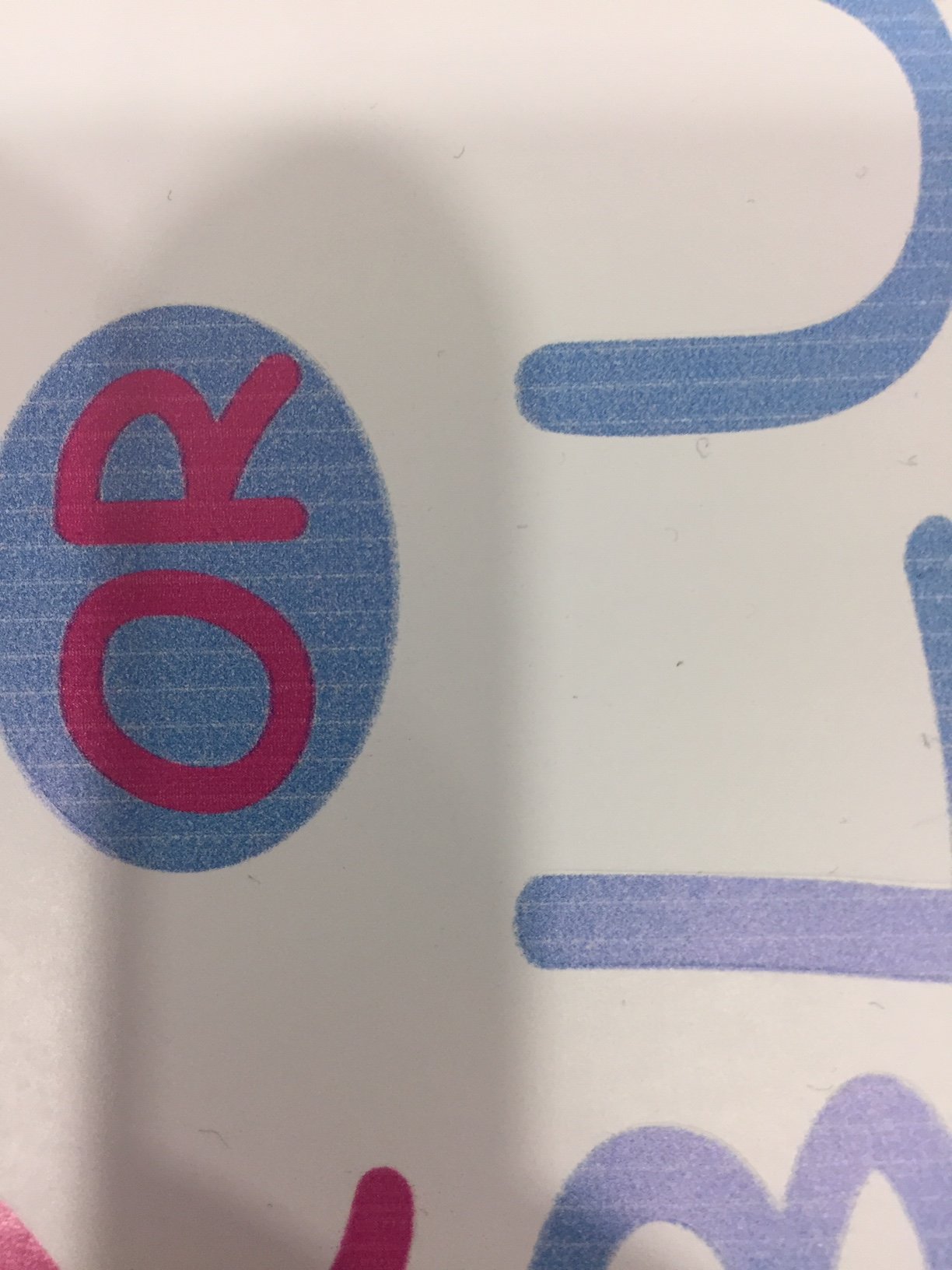

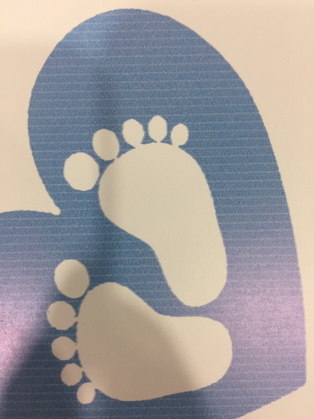

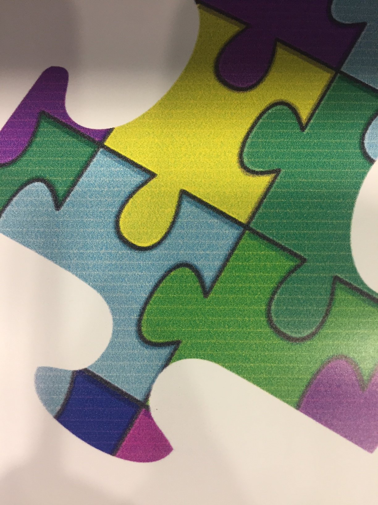

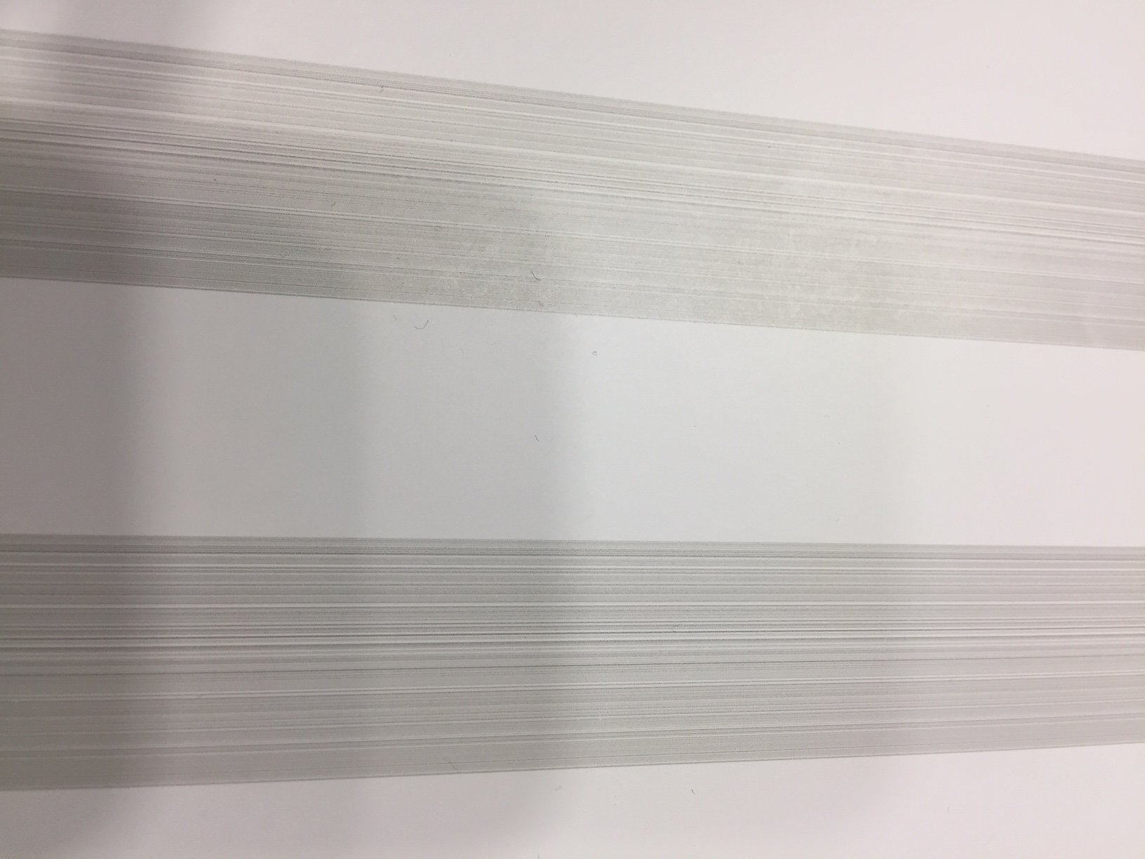

Hi, I keep getting this lines in the printing, i was try to find a solution in the forum but no luck.
I replaced the cap and cleaned many times but the quality is still not good.
I was also hoping that maybe someone here know can give me some paid training on the machine (my store is in paramus NJ)
Please if any one can give me some guidance i would really appreciate it.
Machine is Mimaki cjv30-160
Thank you very much!

I don't have a Mimaki but it looks as if your printheads need to be cleaned & re-calibrated or one or more replaced.
henryz
I used Mimakis before and looks like your pass setting could be low like 8 or 4 try 16 and make sure the media is solvent compatible if not follow step 1 and 2.
brandon708 i did many cleanings to the print head and replace the cap, i'm not sure how to re-calibrated. I hoping it's not a bad print head, i just got this machine used, and i'm still trying to figure out the all the settings. every tech company i was talking with wanted over a $1,000 to come over.
henryz, thank you i'll try to figure out how to do that :)
Hi Jay, sure. dosen't look too good. but when all ink was full i still had the lines.
Thank you guys

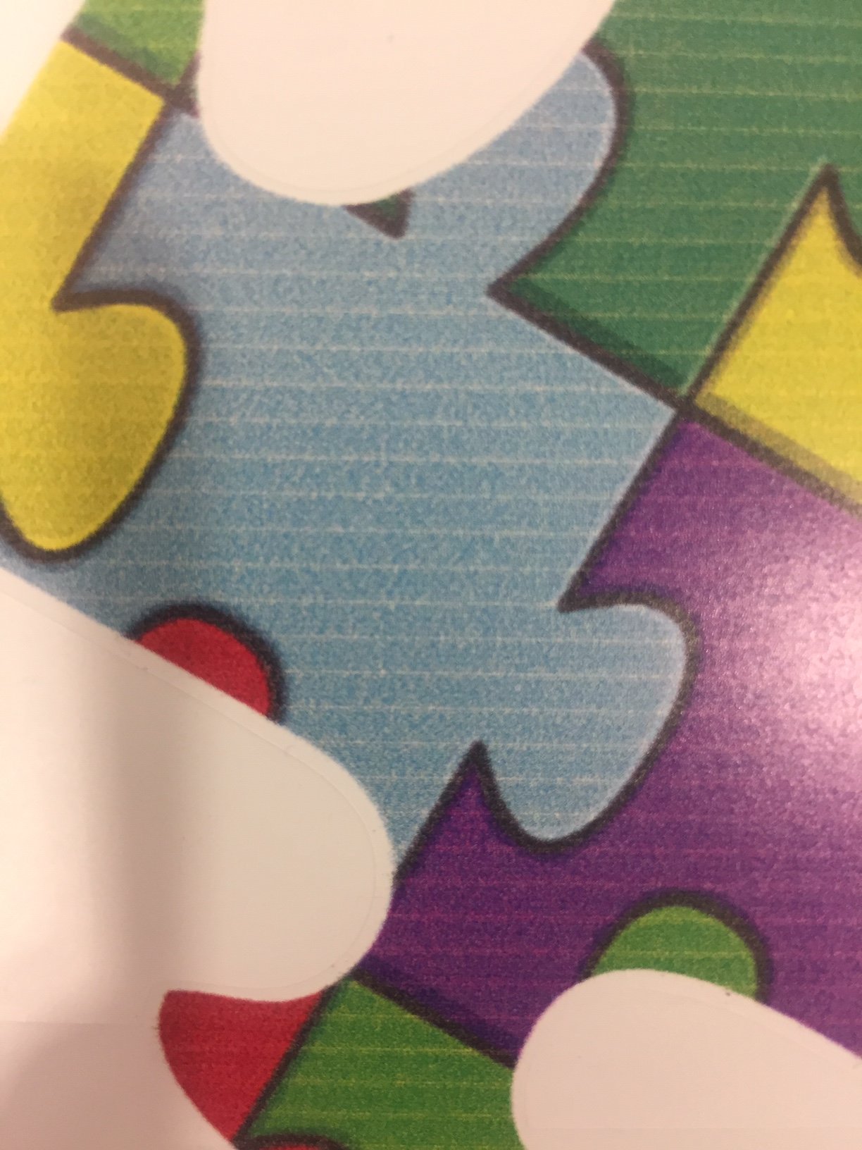

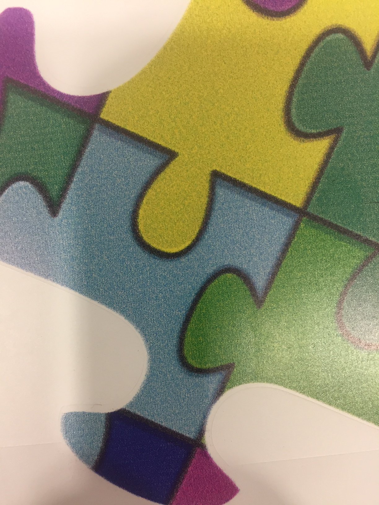

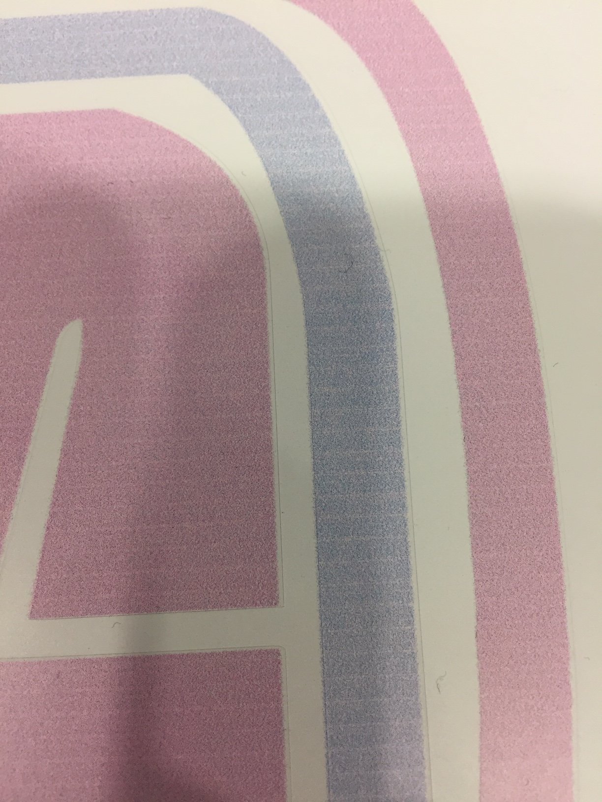

henryz i change the pass from 12 to 24 in the resterlink print condition, you can see the diffrence in the 2 pictures, it looks a little better, but the image is still not very crisp

equippaint
Your best bet is to hunt down a service manual and go through the head adjustments. If you're going to keep the printer, it will be well worth buying If you can not find one to download.
ddarlak
Go Bills!
when you purchased this used printer did you request a current sample of what the machine was printing like when you bought it? if not, I would assume you purchased a machine with heads that were poorly maintained and/or shot.
It definitely looks to be out of alignment too.
RPM
Horizontal banding could also be caused by a bad PF adjustment. Easy to check. check your print size of your file and simply measure finished print.
iPrintStuff
Prints stuff
I wouldn’t bother trying to print any new stuff until you can get a decent nozzle test. Give it a few “hard” cleans and then maybe leave some of the cleaning fluid In the cap top overnight to see if that helps. Have you tried a “fill up ink”
If the machine has came to you in that condition there’s a good chance it’s just the head. Did you get a nozzle test before purchasing?

I just bought a Mimaki and like you I'm new to the machine. Your latest picture looks like your head is cleaned. Have you downloaded the profiles for the media you're using? Once I had downloaded the correct profile from Mimaki's website I had a lot more success.

Heads aren't in that great of shape, hence the grainy prints.
Also, the material feed between passes needs adjusted. I can't recall 100% what it's called but it is adjusted on the machine itself base doff the "baseline" calibration that is done when you align the heads.
You might have to start with head alignment or possibly replacement, but that is pricey.

I’d worry about getting a decent test print before doing anything with the profiles.
Have you done any hard cleanings? Basically in print mode, hit the cleaning button, scroll down to “hard” and hit enter. Do that a few times and do a test print each time to see if you’re getting any nozzles back. If you get any back, keep doing it!
I’d maybe start with a scroll through the maintenance menu and try a “fill up ink”. That should help.
