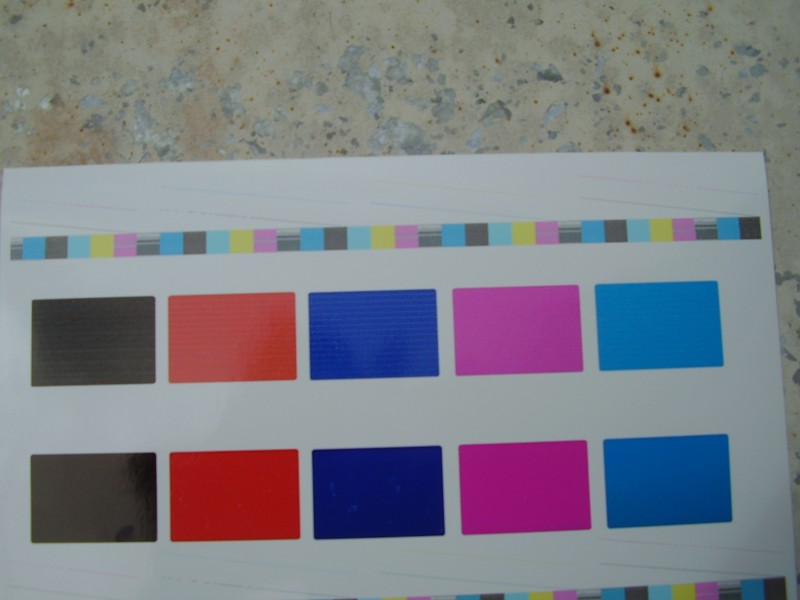

Bradster941
Hey Justin, does it look something like this?

Derf
Flame... if it is your dampers it is an easy fix however
it is easy to tell if it is a print head or a damper problem. Post a nozzle check. If the print is clean but the nozzles are missing then time for a new head. if your colors bleed together or slowly stop printing with big areas of missing ink then it is probably a damper, feed line, or an O ring seal issue.
Post a nozzle check! let us take a look!
