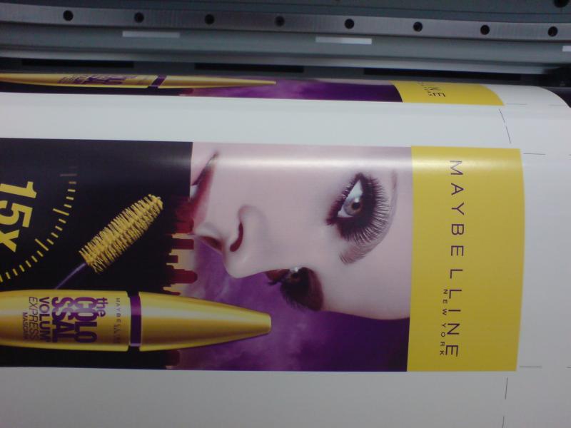

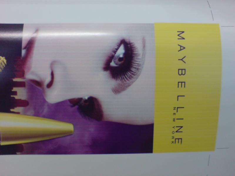

I have a Roland SC-540 and lately when i print sth starting from the right side it leaves lines for about 40-50cm (see photo) and from then on the printing improves and the lines disappear. It is as if it doesn't give the right amount of certain colors. I have also tried starting the printjob further away from where it usually begins printing (about 50cm from the right side) but again it does the same thing.

I print on white vinyl on high quality and i have cleaned it. The third print is printed after the 50cm from the right which is ok just to show you that it does it only on the right side.
