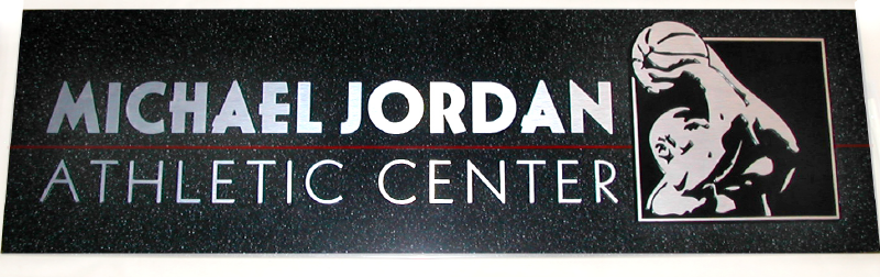

This is a picture of my first corian sign.
It is 30 inches long and 8.5 inches high

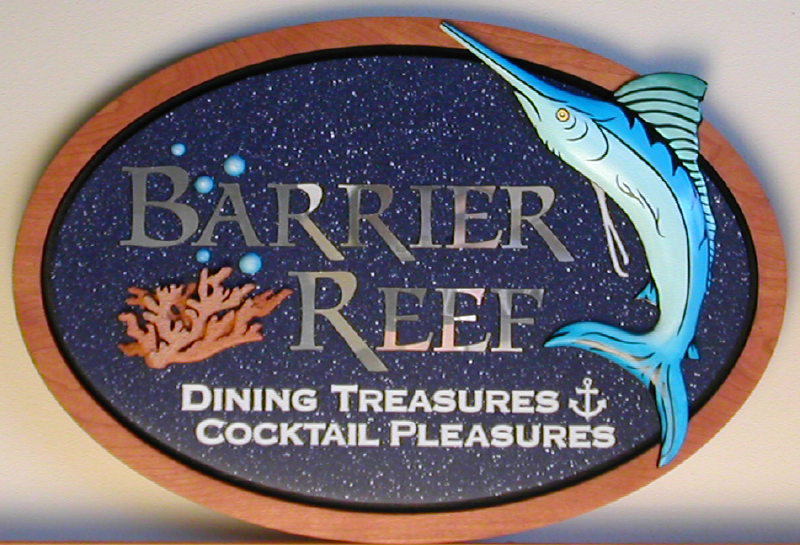

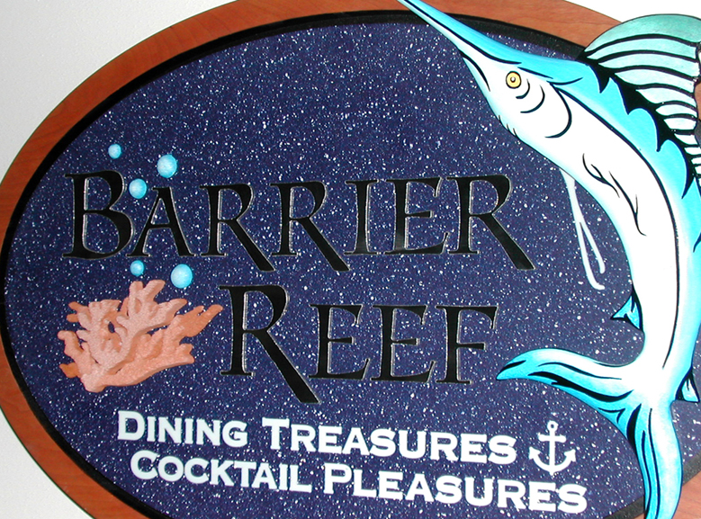

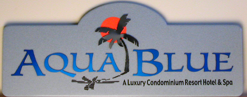

liquid inlay pics
here are some pics of 2 more signs.
The first one has a cherry base,corian insert with posished aluminum inlayed letters.
The sub copy is white inlay,which is corian seam adhesive.
The fish is hand carved and hand painted.
The coral is made of foam and "blast cut",Which is technique we use with the sandblaster.
the second is blue corian with satian blue aluminum letters.
The tree is smoked aluminum and the sun is an orange liquid inlay.
The lower copy and tree reflection are also black liquid inlay.
The inalys are very cool,they become part of the panel and can be polished like the corian.
Both Design are in the D&D stage and some adjustments may occur,but i think they are a good base to work from.

i put up another picture that is a different angle.I have some better photos but i have to resize them and post ASAP.
