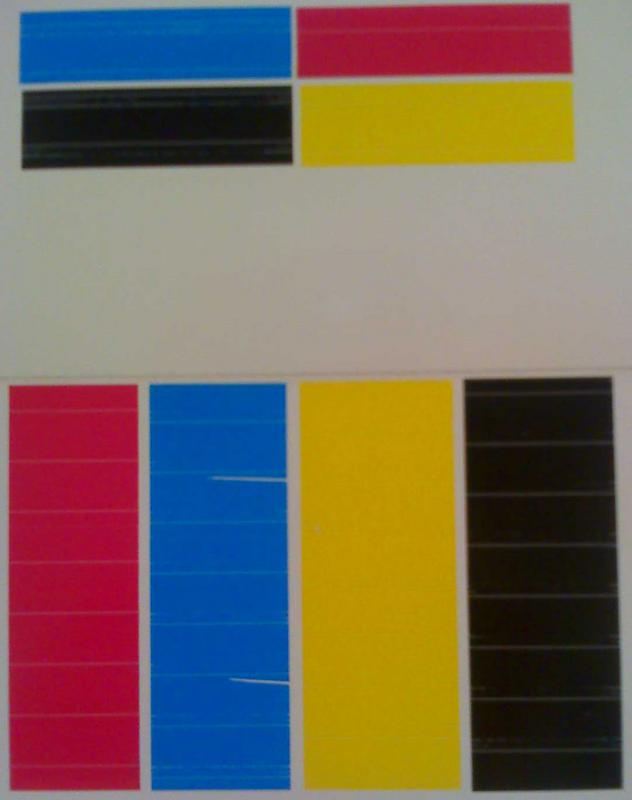

Can someone tell me for sure if a new head would fix this. I have attacted an example of what I get no matter what color, how I adjust or what I clean.

Looks like a scratched head or something is preventing heat from hitting your ribbon creating an absence of color. Usually with a 60 or 600, clearing will make most banding disappear, but that is not banding. Try cleaning with lots a alcohol.

I just printed 4 blocks each direction of the main colors to see if I could tell what the problem was. MCYK. Each line is in a little different location with exception of the blue having another issue. So is is banding of not?

Looks like a bad pixel in the print head or you need to do a line pitch adjustment.
The angled scars in the cyan is caused by a wrinkle in the foil.
weaselboogie
Scratched head. Pc-60 and pc-600 were notorious for this happening. We had a 600 at our shop and had to send it in 2 times to replace the head. The third time it stopped being a printer and enjoyed it's new life out to pasture as a vinyl cutter.

After the first scratched head, we would clean the vinyl religiously before a print with alcohol, but it still happened.
