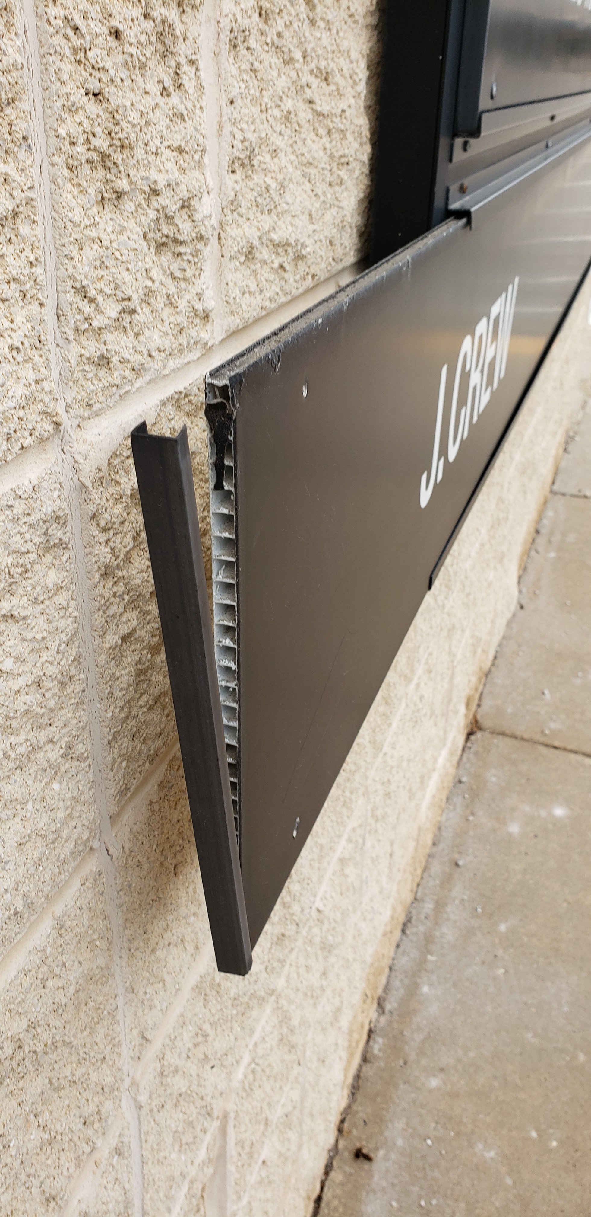

Need 1/2" or 10 to 12 mil. Double-sided Matte Black Alumacore type fluted substrate. Can find white but need matte black.

that image shows white flutes with what appears to be painted.

Definitely not less expensive doing double sided matte vinyl on 30 pieces and then applying matte cut vinyl. Painting, not an option because..... I don't want too. This product exists somewhere. Although the flutes are not black the face pieces are a solid black front and back of the veneer.

Why bother with the back? It installs against a wall. But he's right. the flutes on the originals are white, which means it was white on the surface, and the previous sign company painted them black. The black Aluma-Corr I saw at N. Glantz was gloss. I don't think I've ever seen matte finish Aluma-Corr.

Here is what we did a couple of weeks ago on matte black 3 mm ACM. We need to make the newer, thicker signs similar (read exactly) in appearance. Can go with LusterBoard but was hoping to find a lighter option. Since the frame already has an aluminum core product was looking to stay that way. It obviously exists. I disagree that it is painted. The aluminum veneer is black on both sides. Hard to believe that someone could paint the aluminum clad black on both sides and leave the flutes white.
As far as both sided. When a new tenant comes in we flip and apply. They do not like the outline of the previous tenant to be visible. Their call, not mine. We keep spares for the third tenant and repeat the process but only for the ACM because the "fluted" product hasn't needed updating until now. Not a lot of turnover so it works fine this way. Also, some of the sign frames are visible from both sides.

nice signs! i can confirm, they are indeed painted..... as I made them over a decade ago :)
we used to have a stock of those panels already painted to save time on tenant-swaps, but those are long-gone. pretty certain its still just Matthews Acrylic Polyurethane Black with a Satin finish because the only thing to get repainted was the red-to-orange during the conversion from PrimeOutlets.

Wow, Thank you for the information. I have been schooled.
