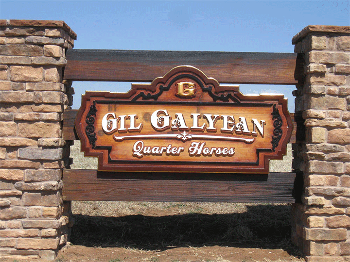

Joe Crumley
Eddy,
I topcoat all my natural wood signs with Sikens. It's the Rolls Royce of clear topcoats. The product is made for log houses. However it takes a day or two to set up.
Joe Crumley
www.normansignco.com
