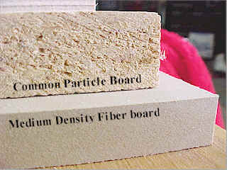

I think you might be talking about the fiberboard type of MDF. I've asked for MDF and it seems like everytime I get something different. The heavy chunked stuff would be more like an underfloor board.
