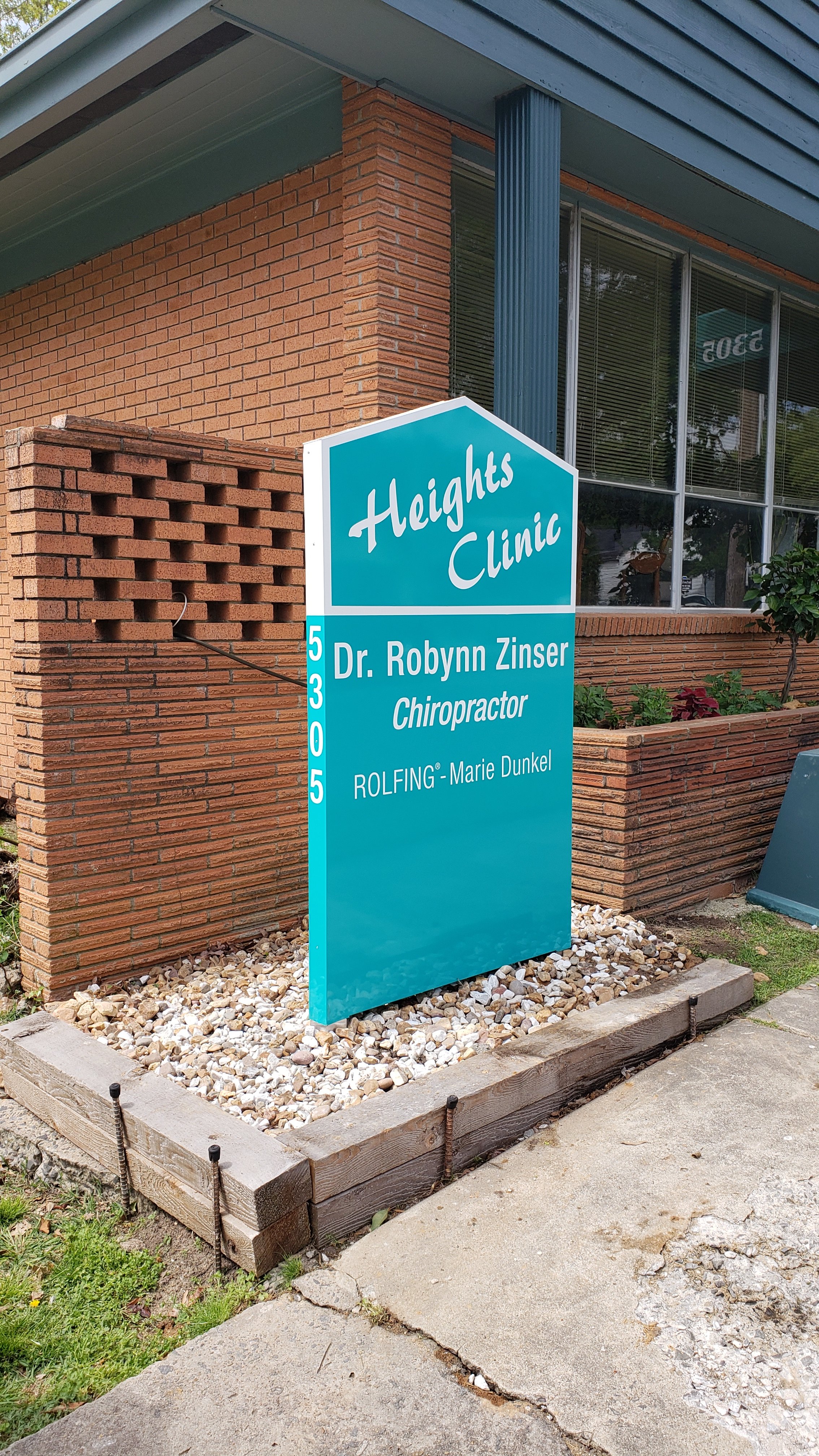

One of our staple budget/profit friendly items are 1” thick pan-faces panels made in-house using a v-bit, handheld router and jig with aluminum composite to bend the edges. I recently found a way to make a single sided post and panel with triangular top that was ALMOST seamless on 3 sides (other than the 3 points of the triangle). The client was ecstatic with the product/price ratio, and we were happy with the product/profit ratio. I’m wondering if anyone has any templates, or creative tips/tricks to maximizing the ability to shape aluminum composite without the need of expensive equipment?

I would love to see a picture of the sign you are explaining here...?

Thanks for the pic Drew, and it's big rez enough to zoom & inspect.....Looks like nice joinery....

very clean looking, like the address added to the vertical edge.
zooming in on the image is that backside face the same white/turquoise as the front or just the standard baked enamel white?
for the top of the "triangle", how did you seal it off? V-grooving and folding the flaps leaves a peak opening but the image appears to be seamless on the front edge of the side angles of the top. and I don't see any hex head screws as fasteners if a seal piece was used.
That face looks deeper than 1", or are you talking about 2 different products in the OP?
