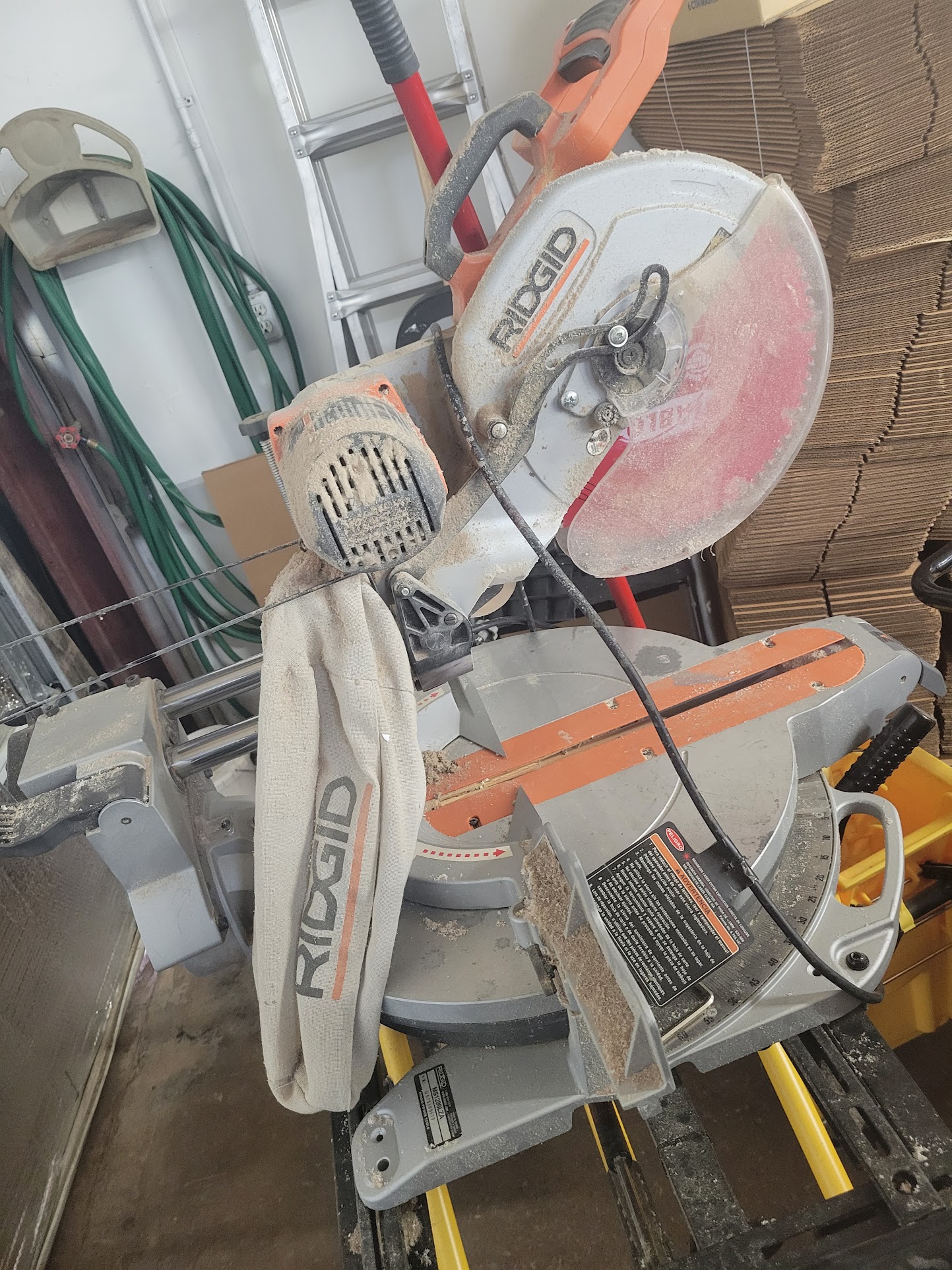

We use a sliding miter saw.
You tape it up with a few rounds of tape and just cut it down.... We use a fine tooth, but I've wanted to get a non tooth one and see how it does. It's a little rough on the edge, but still works ok.
I've looked and looked.for a slitter, they're all for industrial use only and cost like 15-20k.... Didn't make sense to bring it in house when our suppliers only charge $10. For the few times we need to do it in a pinch, a miter works great.

I use a sliding miter saw now, just want something less dusty and something I don't have to roll outside. Cutting with the miter saw is great just hate the cleanup process after cutting 10-20.
Might try to make a slitter out of an old wood lather I have, seems simple just no time

Have you tried using the vacuum port? I haven't but worth a shot for a cleaner process.
I'd also suggest either building a rig with wheels to let you turn the roll on as you're cutting, or get one of those premask dispensers and grind the edges off so you can drop a full roll on it and turn it. I never seem to get the roll spun over without misaligning the second cut.
ikarasu
Vacuum wouldn't help. The problem is (at least with SAV) is the glue trends to make the dust stick everywhere.
The teeth chew up the vinyl, whereas a non teeth blade slices it.... That's why I want to get a non teeth blade one day and see how it does.
Production splitters are the same concept, theroll rolls and the top part is a knife, so you're cutting into the material produces a pretty much dust free cut.... I still think buying a toothless saw blade and using that should cut down on so much of the dust theoretically.

This gives me an idea to somehow combine a lathe with the miter saw using the toothless blade. Lay the roll on the rollers, spin it with lather and use the miter saw toothless blade. Now if I only had time

I can't imagine what a toothless blade would be used for, nor could I imagine where the material goes between the two sides of the cut. Unless you're spinning an incredibly thin blade, I would imagine it would bury and wedge in the material. Not to mention, where does the heat go? If you were able to rotate the material at the same rate as the blade, you wouldn't generate as much heat, but that would be a challenge.
I was toying with idea to make a smaller 'toothless' blade out of 1/4" aluminum to cut down extra wide rolls of tape, but the conclusion I came to was how can I make a part stiff enough to cut while narrow enough to fit in the space betwixt.
Yeah, something like that, though in an ideal world something like a take up reel on your laminator would be ideal for turning, though I wouldn't put a saw anywhere nearby, and I'm unsure how to make a rigid enough blade mount to not wobble all over the place without doing too much to the laminator, hate to give up one tool to make another.
Here's a though, why not pick up a cheap-ish automated laminator, then just run the material through with a blade mounted along the path? It would be slow, and more prone to scoping the material, but it would be dust free-ish and not as 'risky'.
