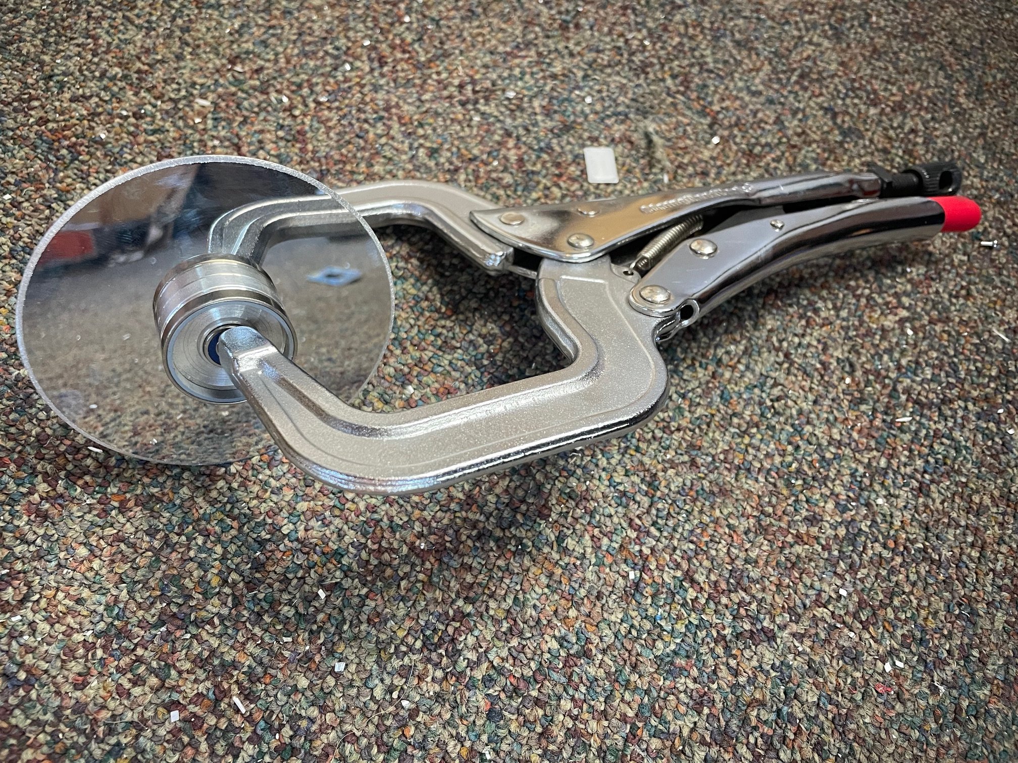

Second, I have been mulling over the idea of a premium pizza slicer that Humble brought up (which I'm sure is just a garbage blade/handle in a fancy package), and I'm like, I just need a thin piece, with a tight bearing, something that would typically spin fast, something stiff.... I present, the most premium diy pizza slicer:
It's a HDD platter and bearing, sharpened on a bench grinder, held with a c clamp. Someone tell me how toxic this is.

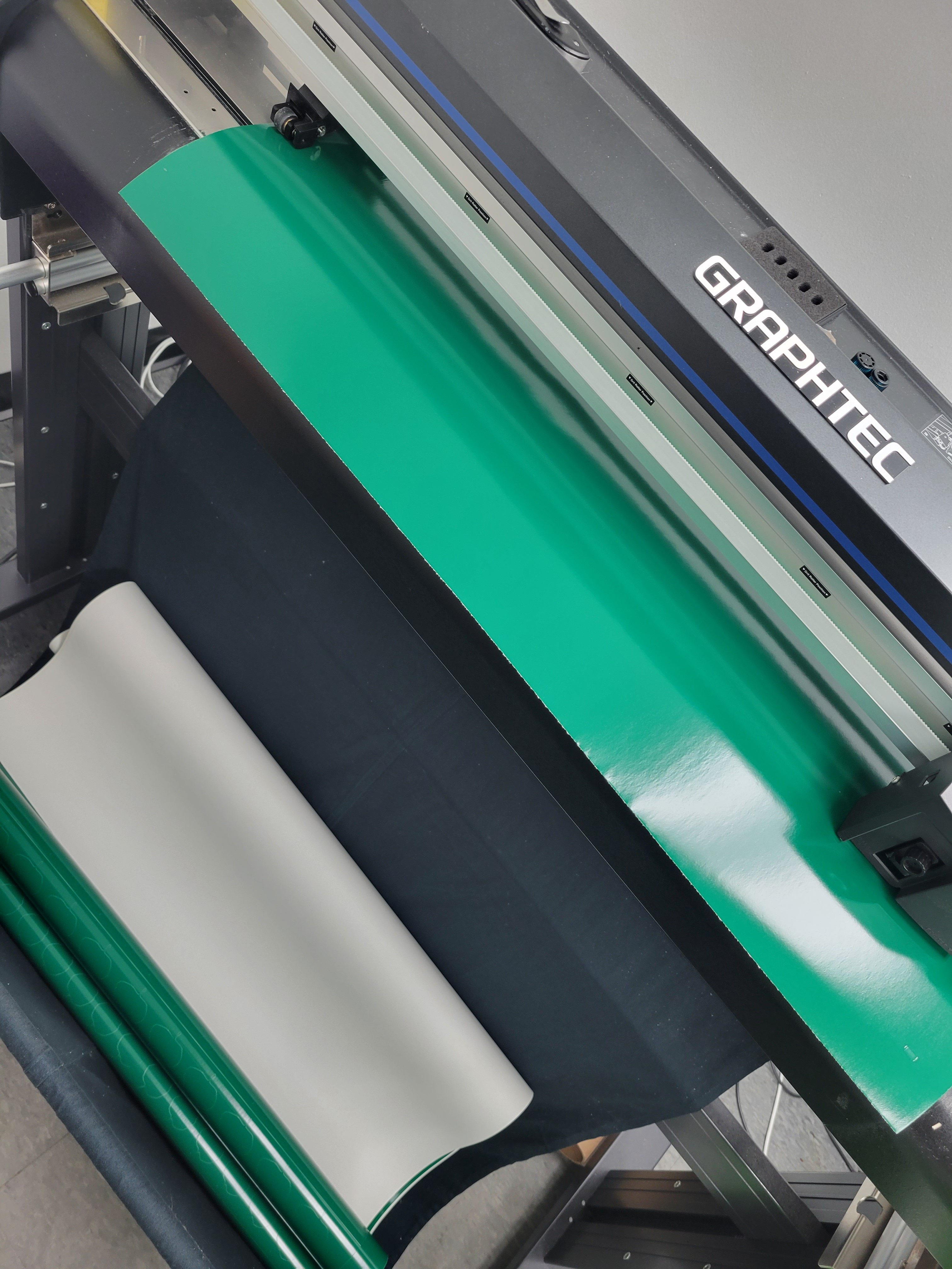

Mine cross cuts pretty cleanly and I haven't changed blade in forever
Wild, on 3m vinyl with clear backer, it shows each cut, with the middle being a 1/16" shorter than the rest. Maybe the film is 'stouter' than the paper backed stuff, and each plunge is drawing the material backwards, until the last cut which is not a plunge.
