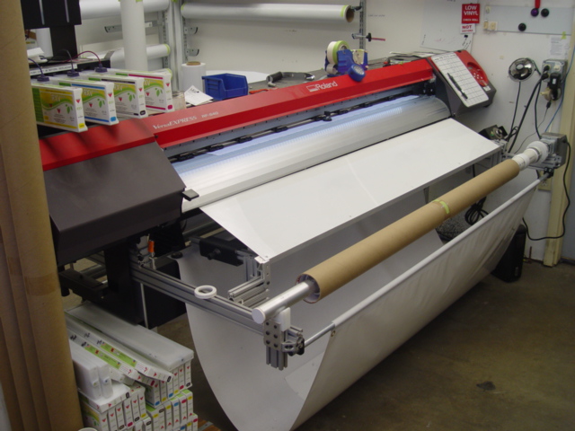

Gene@mpls
This is my setup- I built some 80/20 structure to support my winder (up in the air where an old man can service it) and the BB heater (under the .040
alum sheet. You can buy the heater without the stand BTW.
