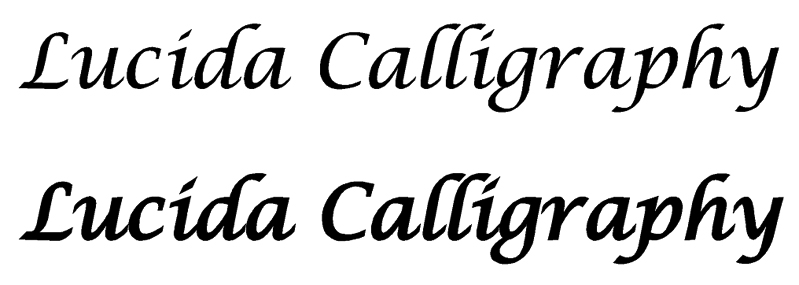

On those rare occasions when I have bolded up a font, I did it by outlining the font without keeping the original. The amount of outlining offset to use is very little ... typically about 1% to 2% of the cap height is about all you can apply before it gets obvious that the font has been modified. You should also pay attention to the join types, usually sharp corners, to retain the look of the font as much as possible.
In the quickly done attachment, I have offset the path .02" on a 1" character.

Thanks ......... yes in Photoshop it works well with a minimal outline as you suggested ...
but in Flex/Lxi if I create a minimal outline it makes the font look great or bolded but when I attempt to weld the same color (outline to the original font) it will not weld the outline so that the cutter does not cut the outline. Make any sense? Sorry if I explained it wrong .....
Fred Weiss
Merchant Member
Try selecting the outline and converting the effect to outlines Control +Shift +O. Sounds redundant but the term "outlines" is used in two different ways.
