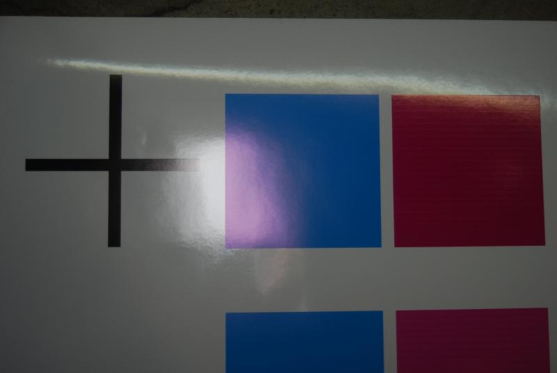

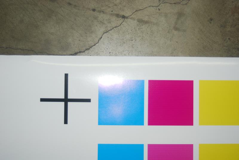

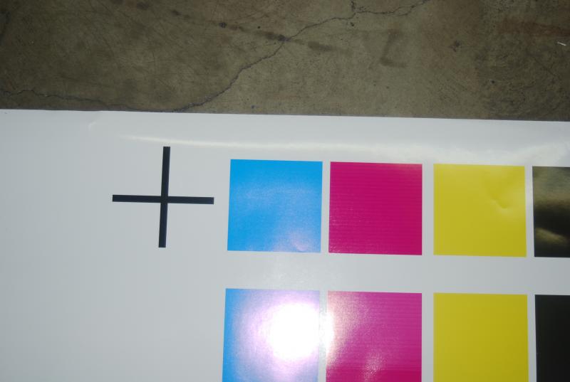

The pictures...sorry our camera isn't that great at closeups
The crosshair looks perfect

sfr table hockey
You could do the artbot test. Swap the mag. damper with another color and do a couple cleanings to recharge the head and do the same test prints. Where the mag will now be printing another color you can see if that color looks like it did when the magenta was printed. If that new color prints fine on that head you know it's not the head and most likely a damper or line issue. If that is the case then you should have seen the banding move to the other head.
May need several test prints to see the results. Once you change dampers back it only takes a bit of printing to get the heads cleared again and back to normal.
This is a very good way to tell if it is that head or the line.
