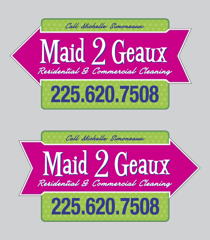

I've been getting bored with the standard rectangular magnetic signs that we do, so decided to do something a lil different... Cut the mag into a custom shape. I've kept this shape simple so I'd be able to cut it out with a straightedge. Please let me know what you think, and if there's anything you'd suggest that may improve the design. (Colors and all wording was requested by customer)(BTW "Go" or "Geaux" is a cajun thing down here in Louisiana for those who don't know)
So now the question... How can you/do you cut magnetic material into custom shapes?? The material sticks to our plotter, so I assume that won't work. Other than cutting by hand with an xacto knife, is there another way to do this?

I use an exacto knife or utility knife. two passes at most and a steady hand on the curves. Straight edge as a guide on the straights.
Mosh
Round the points on the arrows, sharp corners will catch wind more than a rounded over one.

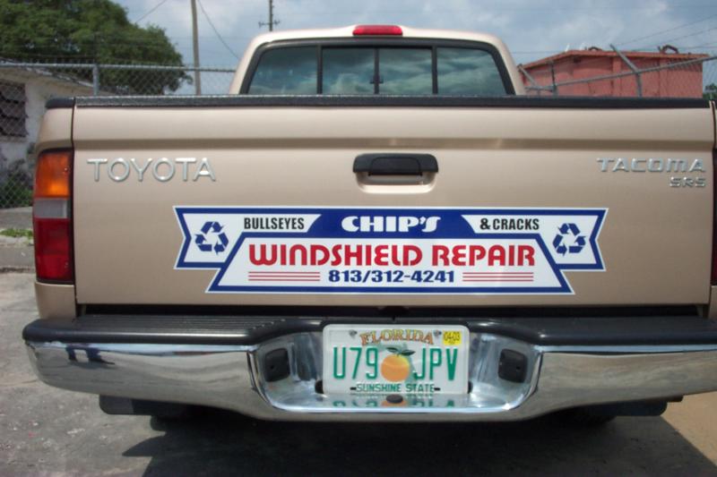

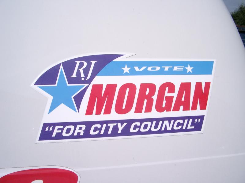

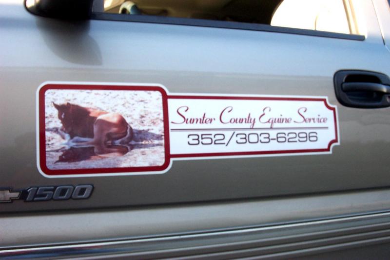

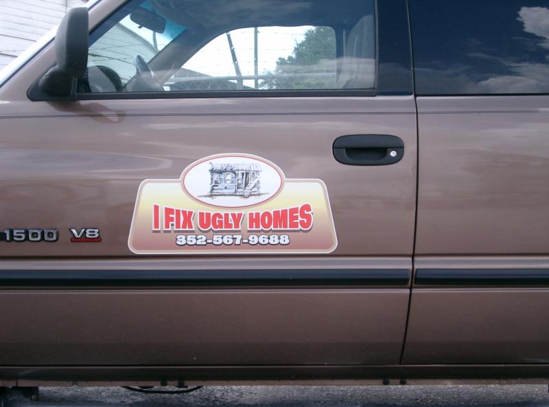

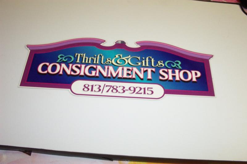

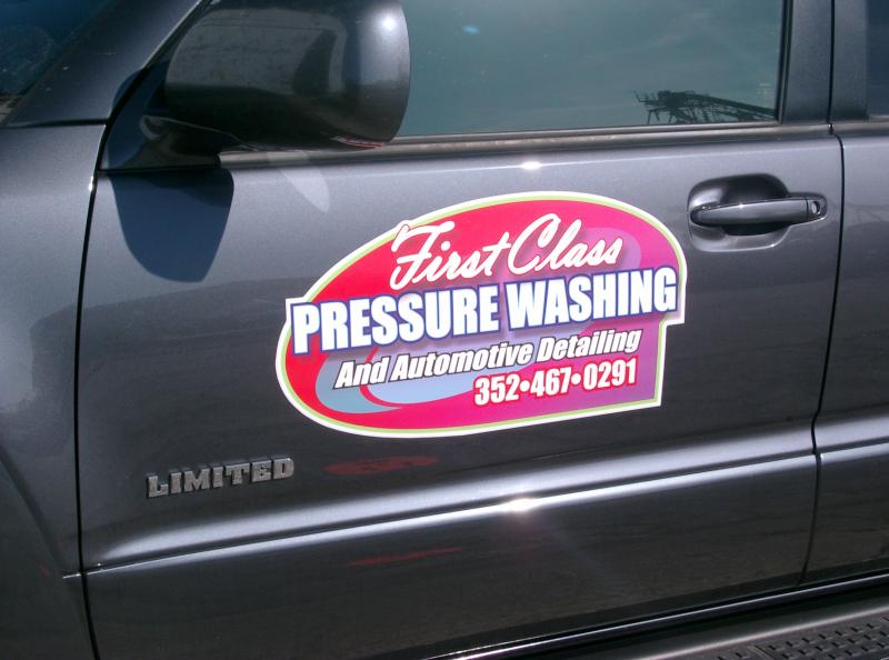

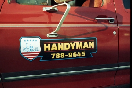

Here are a few different profiles I've done over the years.

Thanks you showing. Very cool! What would you do with the City Council Mags if they ordered a large quantity? Still cut by hand, or is there a place that you can get magnetic blanks cut to any shape?
SignManiac
I have in the past used my cnc router table with a 60 degree bit to score the mag then it tears apart nicely.You could sub that out I'm sure.
