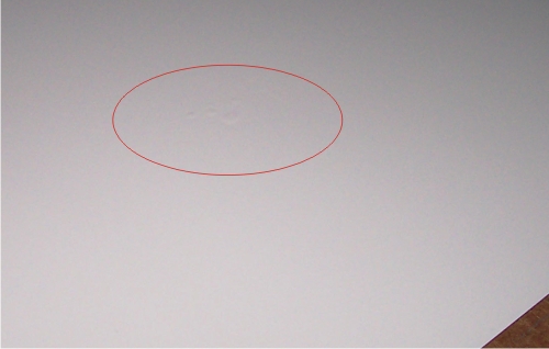

I just received my first set of magnetic sign blanks....Magnum Magnetic "sign in a tube" 12" x 18". There are bubbles in the white vinyl surface, particularly in one area of one blank (see picture). I can't believe this is typical but there are bubbles on both blanks. Is the quality of these things really this bad or did I just get a bad set?

looks like a bad batch to me, can you buy magnetic rolls with no vinyl applied? The vinyl they use is horrible and I want to apply my own cast white vinyl

Watsons....This was all I could find in pre-cut blanks. We don't have much call for magnets so I wasn't looking for a roll. Having said that, we are overlaying a digital print so I would have been happier with plain magnets rather than bubbles in the vinyl layer. I imagine I would just be making a bigger mess if I tried to strip off the white vinyl that's on there though. I've submitted a form to their customer service, we'll see what they say.
Surf city...thanks, at least I know now it's not typical of their quality.

I just cut off 6' off a 10' roll i bought and it was flawless. Must be a bad batch.

Use MM exclusively, never saw bubbles, but see what looks like "sand" under the vinyl all the time. Just ordered 2 rolls from Grimco. Never get it from them but they had one of their "Friday Specials" and it was like $74 a roll compared to $123 a pop at Fellers.

I took a closer look at the flaws and discovered it's not actually "bubbles" in the vinyl but rather that there are bumps on the magnetic material under the vinyl. I've spoken to my rep at Grimco and with Cameron at Magnum Magnetic and have another set on the way to me. I wish I hadn't received defective blanks in the first place but it's nice to know there are still some vendors that believe in customer service.
