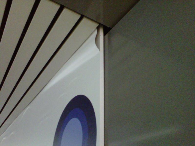

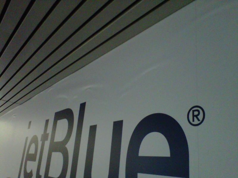

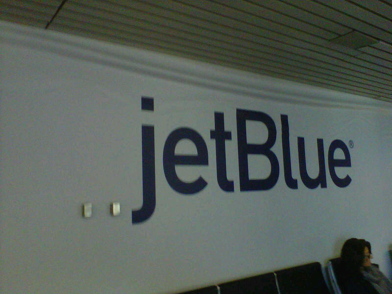

This is horrible....just got these images from my client who installed in Chicago.
Now have to jump thru 3M's hoops!!!! :banghead:

did they forget to squeegee to the top? it looks almost like you can still see the edge of the squeegee where they stopped in a few of the photos......
Letterbox Mike
What is the substrate? Was this IJ35 or IJ35C? I know from experience IJ35C does not like painted drywall or Gatorfoam or other surfaces that are either somewhat porous or not at least semi-gloss if not gloss.
Mikeifg
Is that the Matte?. If it is I believe it's not the vinyl but the surface itself. The installer should have heated it also.

Surface is Painted drywall....at least a few months old. Not sure matte or semi-gloss.
just looked at lot #'s and MFR dates...all 3 rolls...same lot. All 3 rolls...Dated 031411....nearly a year old stock on this.
60in, 200 yd rolls.
Letterbox Mike
My bet is the drywall. I've never tried to stick regular IJ35 to painted drywall but we've had IJ35C fail miserably on it. We did a test wall here at our shop and within days it was doing the exact same thing your is. We resqueegeed it one Friday afternoon and it was on the floor the following Monday when we came in.
We've also had it do this on Gator. It sticks great to sealed surfaces like ACM, aluminum, PVC, etc., but it does not like anything else.
Bummer though. Good luck with 3M... :frustrated:

This doesn't look like a material failure.. Was the wall test done before install? Do one now. I'll bet it doesn't pass...
Wrong material for the job.

I have a feeling there's ultra cold air coming through that ceiling right there..

ij35 is great, That wall could very well be damp, or maybe cold air form outside?
or maybe have a leak causing condensation. Or maybe just the paint. Hard to tell unless on site.
