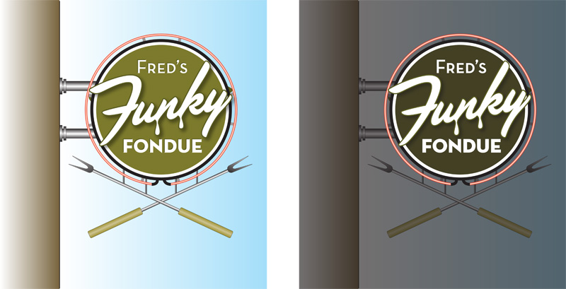

Rick
I have to do this all the time, I put a warning on the
page that it's just a simulation... I mean really, all drawings
are simulations...
I do this in Illustrator, but works the same in Corel
I put a CMYK black over the whole image, adjust the
transparency, the move the "lit" portions of the sign
on top of the transparent black. If it's halo lit, I'll add
a glow, I can also add a sign glow to the lettering.
I did these 2 a while back for classroom assignments here...
I also do client presentations where animations is involved.
http://www.iamglak.com/eddie-mate.gif

I like the animation one. It was pretty cool. But neither looks anything like it will in real life. And unless they just have absolutely no imagination, doesn't help the process at all.

Thank you!!!!
Very nice work.. I really like the animated gif
I just think that it is part of a nice presentation to show a concept... I see things like that all the time with construction companies and lighting professionals...
And the lighting never looks exactly like it does on screen or paper.. it's just a concept, it's part of a presentation
Rick
Those were not for any clients, it was done for the forum...
Most small mom and pop clients have no imagination... it's why
we get to design. It's also a request, I never freely offer it up.
Geez, just thinking about this, I mean all the renderings I've done that were
requested by theme parks, designers, architects casinos, hotels and malls and
I'm now informed that none of them had imagination? Who knew?
