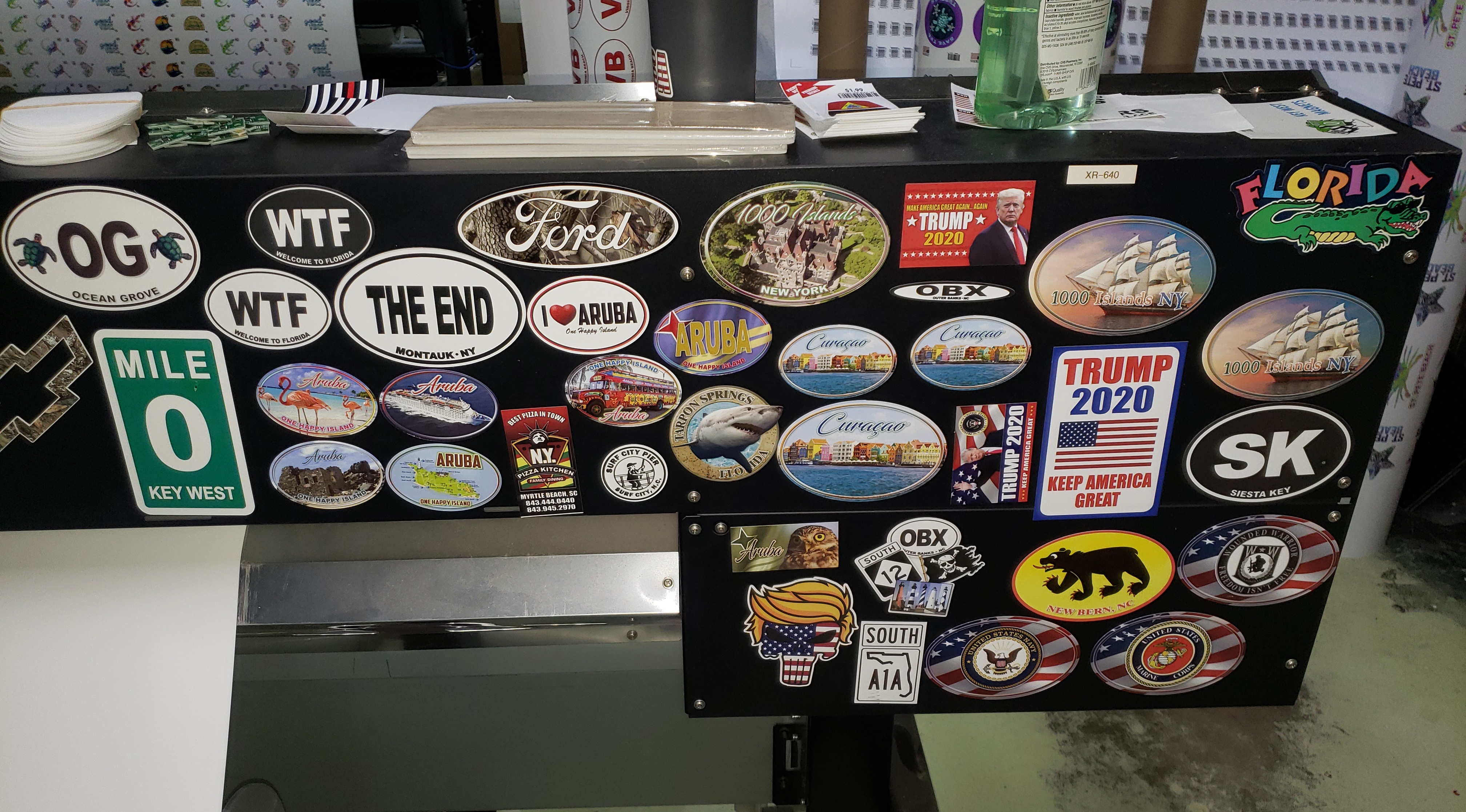

rawjahprintshop
Anything the customer wants, and more.
Here are some samples.
Hey, what is your appplication process? Are you printing directly onto the magnet material? I was going to put just a 3-4 foot piece in the machine and it seems very unreasonable to ask the machine to pull that weight of the material through the machine.. Do you print, install the vinyl onto the magnet material, and then cut it? Figured that would be a little easier on the machine... Im using .030 thickness.
