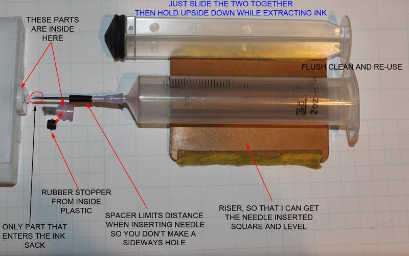

96XP
Curiosity got the better of me too one day.
So, YUP! .......... I do it once a year with my 'empties'.
Not because I'm cheap, but why throw away a few hundred dollars?
Those cartridges add up, and that puts gas in my skis. :thumb:
