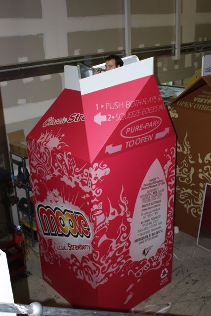

Thought id show you a project we worked on last year for a milk company that was launching its new packaging in Sydney, Australia.
I put together a video for YouTube showing the process of making them, you can have a look here:

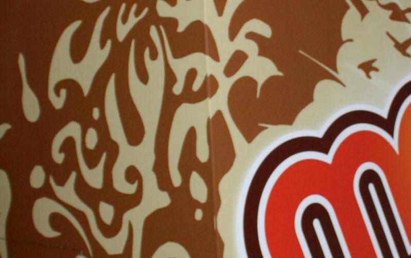

Did you have to do anything to the joints where the panels meet up?
I.E. an extra strip of printed vinyl to cover the joints?
(the joints look seamless in the video)

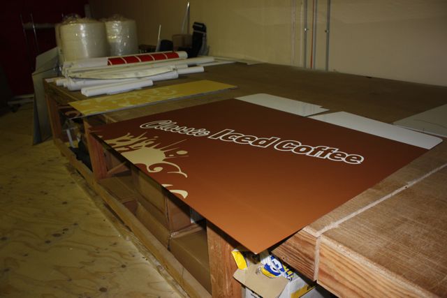

For the sides we printed the vinyl with enough bleed that we could wrap it around the back of the aluminium composite panel (to cover up the black edge). This then lined up with the graphic on the next panel and worked really well. I have attached a close up image to show the joins.

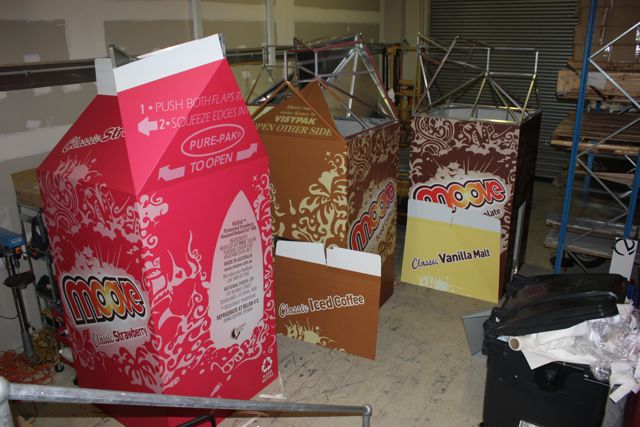

For the top panels we did the same thing however due to all the complex v-grooving and the frames all being slightly different they didnt all line up as well as the sides, but being 3 metres high people can't see the joins very closely at the top so it looked great.

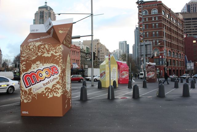

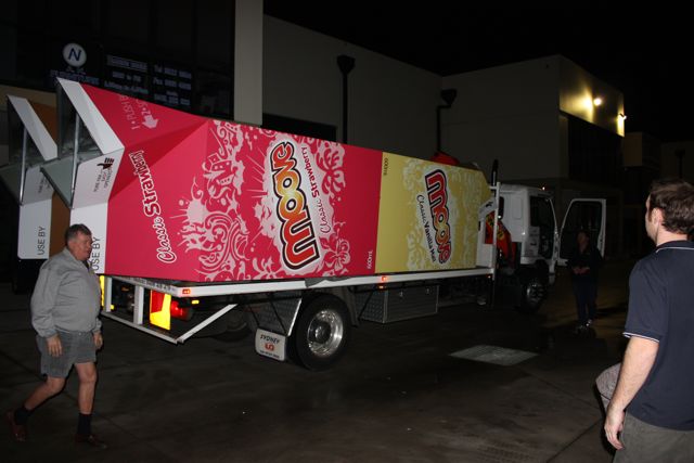

The finished cartons were rather heavy so wind wasnt a problem, however we were leaving them unattended in busy parts of the city for 24 hours at a time (4 different locations all up).
In view of this we built a small door on the back that could be unscrewed, we put 150kg of sand bags in each for some extra weight. (We imagined drunk people walking home from a big night out would have a great time trying to tip them over).
Over the whole campaign only 1 was pushed over and 1 had a little bit of graffiti that we were able to clean up. So overall a success :)
