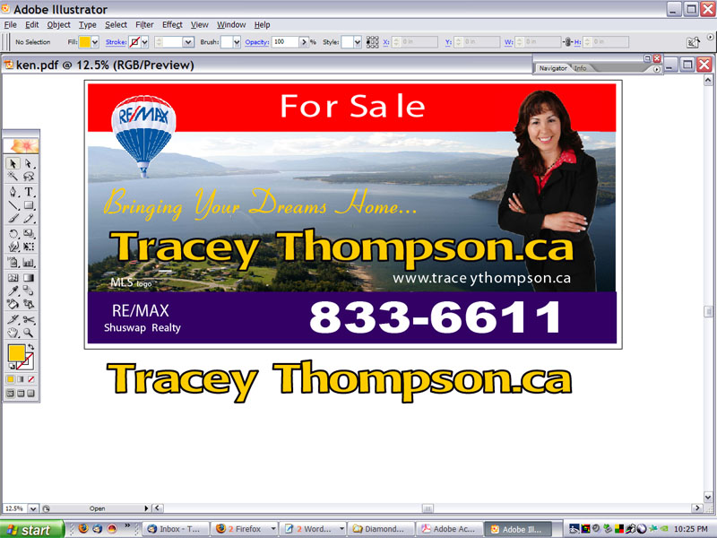

Why do a trace ... open in Illustrator, select the text, copy and paste.

Thanks Fred and Shovelhead. As you can tell, I'm not real savvy with Illustrator..I'll give that a go.

I tried opening and also placing the file into Illy 10 , but it comes up corrupted. In fact the text I really want does not even appear at all. The .pdf was created in Corel 12 by the client. I'm just trying to get him to send me either the font, or the whole file in.cdr and I should be good..frustarting tho'.

Son of a gun Fred...you da man..and I'm the idiot.
I also was able to simply open that in X3. Text converted to curves. Not sure if I have the actual text or the outline ( contour), but it is there.
Uhg..
Thanks..Ken
No..it's weird...I'm able to remove the black contour..but when I do that the yellow text expands to the same size as the black contour...?

According to Illustrator CS2, the outline was centered on the letter.
The font Market Pro, BTW, is not commercially available. It is an included font with Microsoft Office 2003.

Thanks Fred..after a lot of drudgery..I proceeded as follows:
Converted outline to object, broke outline, deleted outlines, gave it the cut path needed for the versacamm,
opened it in Colorip 2.2
I'm hoping I'm good to go.
