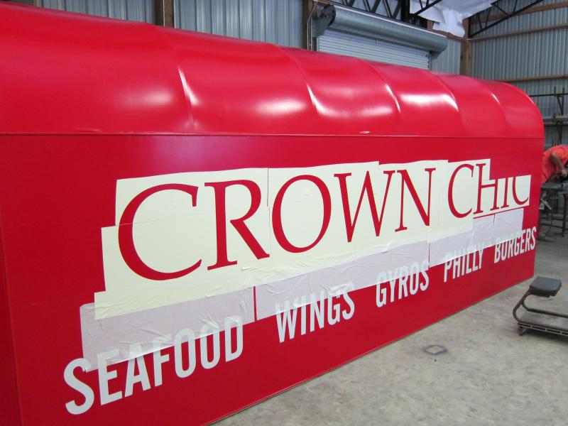

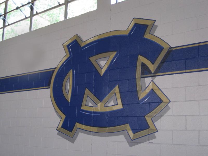

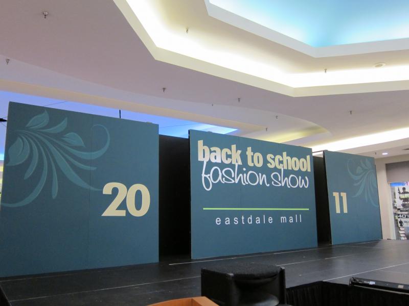

I used to buy old sparcal vinyl as my masking at a local sign supplier. I paid $20 per roll fr 24" x 50 yards. It would stick good enough for a mask and pell right off, it was BETTER than masking. I used a ton of it for eradicating awnings.
I have used it on dryvit walls, brick, automotive...everything. wish I could find some more!

Those are AWESOME! Thanks for the pictures! Any tips?

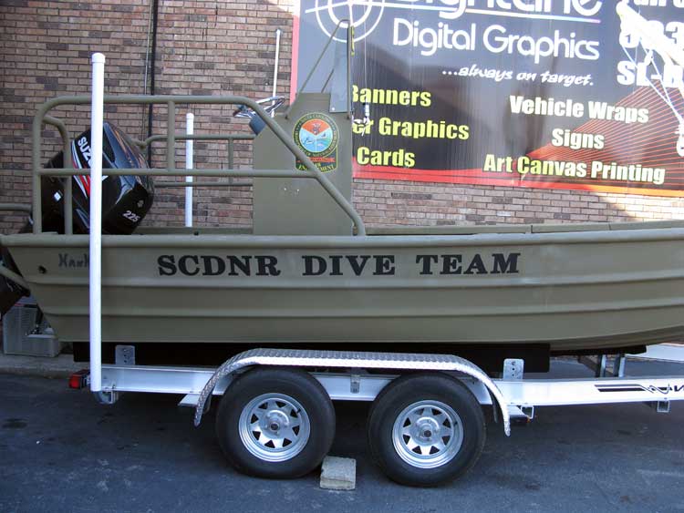

Just not something we often get the call for or the chance to push. Recent one - about as basic as it gets, reverse weed paint mask, stick to boat, paint flat black. Just plain old lettering. But thats what they wanted - the boat is a ultra flat finish and they wanted the lettering to match. Actually was tough because the vinyl, masking tape etc really did not want to stick to that finish at all.

tips? rip it off when paint is wet. rip if off slowly as the vinyl masking will droop and leave marks on your finished product. after you get the basic design down then you can go it and do some detail
