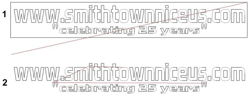

Now, when we cut often it cuts fine, Then all of a sudden the head will just cut a line across the vinyl. Or sometimes, the head won't lift up upon returning home and cut a line through everything on its return home. Then other times the head will just run straight across and slam the plotter (cutting the vinyl) and bang against the far wall. At first I thought this was due to a serial to USB adapter for my serial cable, so I installed a serial card and seem to still be having similar problems. I am going nuts, now that we are starting tpo get a couple of jobs using a plotter again. We are not getting so many as to really warrant going out and buying a new plotter yet (however we hope this happens soon so that we can buy a new plotter). Any help would be GREATLY appreciated.
Here is an example. (Red line is the messup)
The first one is what the plotter was doing before. after cutting the box it wouldn't lift and cut through the rest of the vinyl.
The second is what I am getting today. checked all connections and settings. The red line starts at the a and continues. I stopped the cut at this point, that is why there it ends where it does.

Well, I took out the box around the lettering and tried using the weeding option. This sort of worked, When it was cutting the weed box it was slitting the paper, Then on the 4th try, it didn't lift the blade, but this wasn't too bad as the end of the box was next to home, and the blade didn't cut any lettering.
Then I tried with no box or weed box around the lettering. This worked for the rest of the job. Only thing was that I would cut one at a time (as I didn't want to risk cutting too many and the machine screwing everything up) I ordered a new serial wire and USB adapter from Master Warehouse. I am hoping that this helps, as I have an original OEM serial wire hooked upto a PCI serial adapter card. I am trying to hold off on a new plotter as we are hoping to get enough work to buy our own 60" eco-solvent printer and a compatable 72" plotter. I was figuring that I could get a better deal if I bought them together. I remember one of the manufacturers actually gave a steep discount to the plotters when you bought a printer.
So if anyone has any ideas on what will help keep this Master XY300P Plotter going let me know. It seems to operate fine except for the random diagonal cut through lines. I was even thinking of trying to build an old Win XP machine thinking this might help. I often wonder if Windows 7 64bit is the problem?
