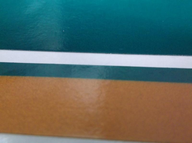

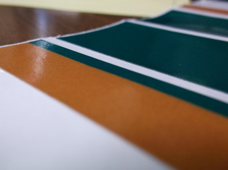

Here is a photo of the sample provided zoomed in as best as possible.
The green pinstripe is only 1/8" and the stripe needs to be 50' long...

I thought so too, but I've never had to match 280 green before; the vinyl is darker and has a more blueish look to it than the printed trans green does.
The Gerber Color ID suggests Trans Green over Bermuda Blue as a color shift of only 6%.
It also suggests Trans Green over Process Yellow and Trans Green over Lime Green as close matches, but using non-trans colors reduces or removes reflectivity.

A TRIPLE-Strike of Trans Green on 280Gold gets pretty close, this may be what we go with for the project... Lots of foil use-age when you're printing a 50' stripe!
