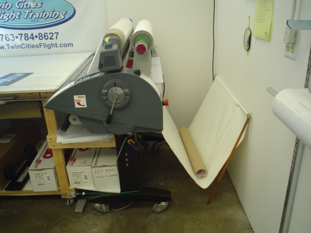

This is the catch basket for my laminator but I have the same for the front
and rear of my VP540. You would want to make sure your ink is drying fast
enough to eliminate prints fusing together. Looking at the photo- this is the
Mark I configuration with my 42" laminator- the legs of the basket now hinge
on the legs of the machine so that it can be easily flipped up and down for
access to the rear of the machine. I could take a pict of the printer basket
if you would like.
