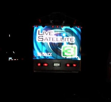

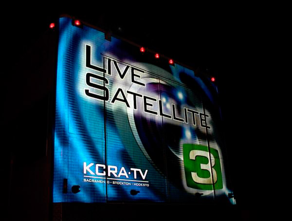

In general glass bead films have much lower luminance abilities as you move into wider angles...that photo's angle is just NOT in the service range, but why one section reflects more is weird. It could be that the stripe got rotated and the film is sensitive to this. That would show at the extreme angle in the photo. There are web issues with glass bead films due to the process used to make them. I rotate tiles so the edge differences arent apparent when tiling big prints. I also mark top for each graphic, so as to avoid any optic differences. Glass bead films have a narrower entrance and observation set than prismatics with luminance falling off rapidly outside the optimum straight on view.
Its also possible the laminate may be scattering light.. or that the film has some defect. If it were me, I'd upsell client to a rotationally insensitive film as they are better.
680 SERIES WRAP.. angular drop-off in luminance of (L) image is pretty obvious when compared to straight on optics of (R) image. Some of your issue is this property of the film.

Excellent post, thank you! I was actually about to update everyone. I finally got a chance to go look at the truck, nothing was wrong with the reflective. It was exactly what you said, the customer was looking at it from an angle and using a bright camera flash. After I told them that the reflective behaved differently at different angles, they went and looked again and are 100% happy now. But to hopefully minimize this problem in the future... I do know for a fact 2 of the stripes were rotated 90 degrees in the cut file, to make the most of the material. I've never had a problem with it before, but maybe from now on everything will have to be cut in the same direction. It's just odd to me, I've never known 680CR to have "rotational sensitivity"... I use a lot of it.

I think the problem is most noticeable in the photo 7. The only vertical pass is most likely the one in question. The only difference is the 90deg difference, so I think if that did not happen, the unpleasant result would not happen either. It's the angle.
It still should not happen, but I see a simple solution.
