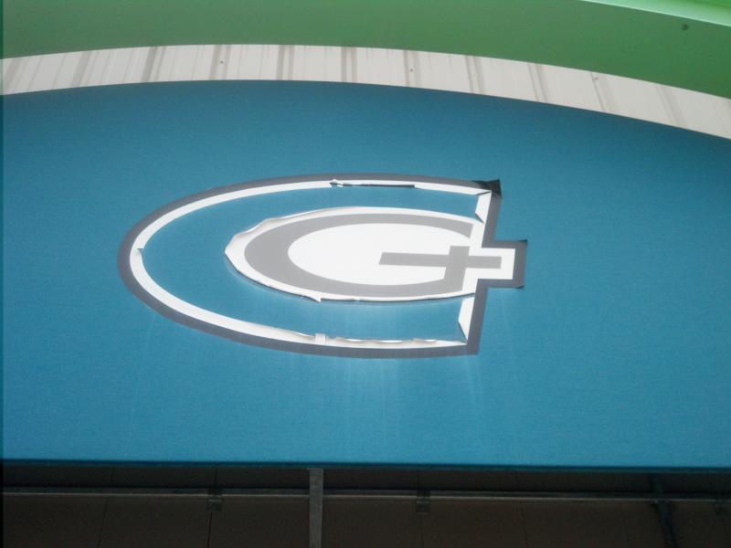

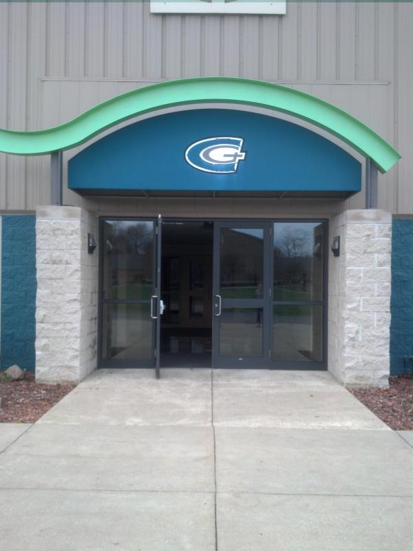

Hi everyone,
I've been asked to do a project and I could really use some advice on whether or not I'm on the right track for this project.
This customer has a vinyl decal attached to their awning and it's peeling away. I had no part in the original image, so I don't know what it is or what they used. The products I have in stock that I would use for the replacement are:
Oraguard 3165RA
Oraguard 210 gloss laminate over top of it.
Printer: Mimaki cjv30-160 with solvent ink.
Am I on the right track in regards to materials? I'm not going to be the one installing this, just sending it to the customer and installation is up to them.
Any tips for removing the old decal?
Any tips for prep before applying the new one?
Thanks!

Looks like it's fabric. Unless you can heat press something on there, your graphic will end up doing the same thing. There are super High Tack vinyls that will hold out for longer, but ultimately moisture, dirt and expansion will lead to the decal's failure.

They need to be done by the awning manufacturer at the time of fabrication. (Usually screen printed) I've never seen a patch job ever look good or last long. The ones that really make me cringe are the vinyl polyscrim awnings, that are backlit... and then some yahoo company slaps a square decal over the old logo or name. Looks like crap and even worse at night.
But after some noob failures early in my career thinking I could do this, I just now don't even bother with them. I say call that number on the frame of the awning manufacturer. They'll hook you up.
Direct printing on that sailcloth might be the closest solution I can think of.
If it's any type of fabric, the proper way is to either screen print it, or hand paint it. Screen ink will last a very long time, but up in the air with 3 or 4 colors might be a little too involved. We've been using a good grade of latex paint for these in the last 15 or 20 years. We used to use 1-Shot poster inks, but have switched. Again, up in the air, you must protect against runs. However, any vinyl applique will fail quickly. There is another material out there called fab-tac which isn't bad. It will last maybe 2 or 3 years, but the colors you need will defeat using that stuff, It can't be painted or printed.
Painting should last about 6,7 or more years at least, if done properly.

To me the way the white oxidation rain stains look... I'd say it's a flex face material and not a fabric canvas cover. Clean it well and use a quality cast film 751 or 951. It on a blue ground and doubt it's back lit and if it is.. not a real need for translucent. But the best way to confirm... one way or the other is to go and look... next would be to talk to the maintenance personnel for the building. That's my nickel's worth :wink:.

peel the existing decal off and put mask up there and repaint what you want. this is what i would do. this awning is not large and there is no since in turning this into a damn awning carnival
your not going to be able to "heatpress" a damn decal on this, its not going to work. the awning is already up and your options are thin. do not turn this into something it is not.
you have 3 options:
1-rip off decal and repaint another
2-take awning down and replace with eradicable or vinyl that will accept vinyl
3-take awning down and replace and apint OR have awning company press a decal down using subnbrella system
