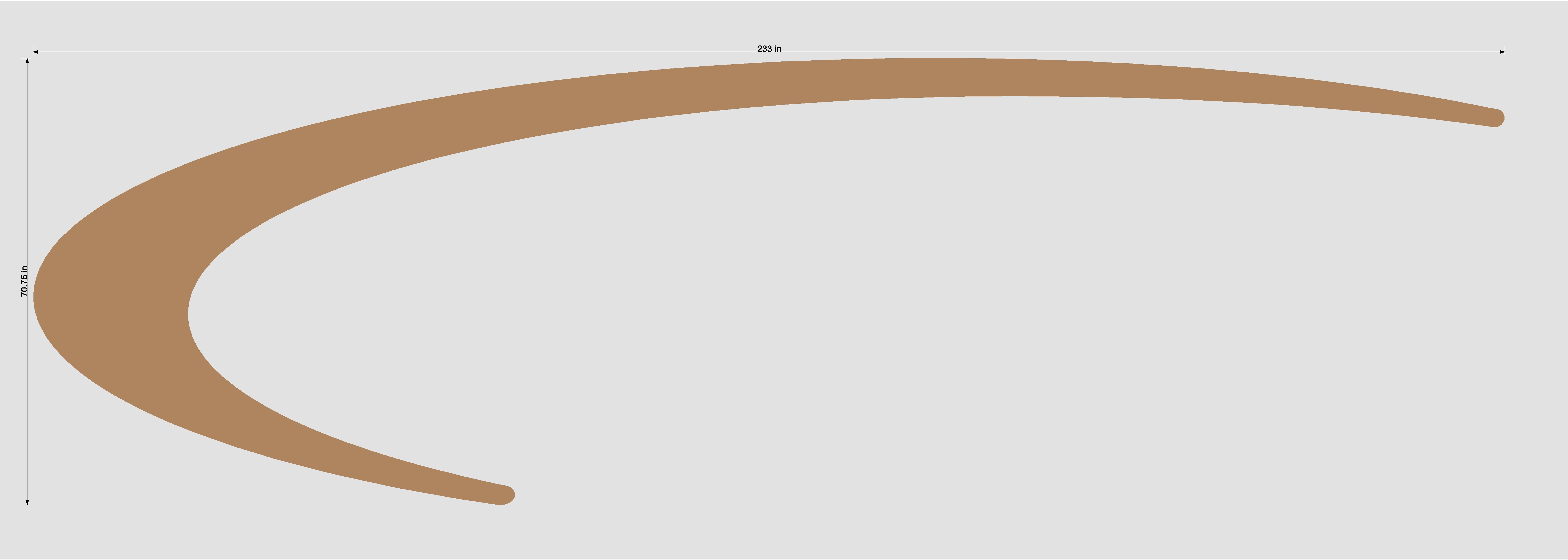

I have a logo in the shape of a swoosh that I'm trying to permit. The city says I don't have to use the over all dims and can use only the actual square footage of material occupied in the swoosh. How to I figure out how much square footage area is occupied by this swoosh? I'm using Flexi. If you drew a rectangle at 233x70.75, obviously the swoosh is not using 100% of that space. I need to figure out how much percentage of that space it's using and that should give me the square footage.

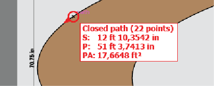

Boudica has it fiquired out.
Doing it the old fashioned way, you're between 19 and 20 sq ft to be safe. It might be slightly less.

I wonder if a link to the tutorial I watched, and a screenshot would suffice.

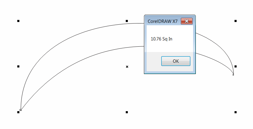

I use a Corel macro for this. Can choose area in mm, CM, ft, or inches. AreaOfShape.gms
