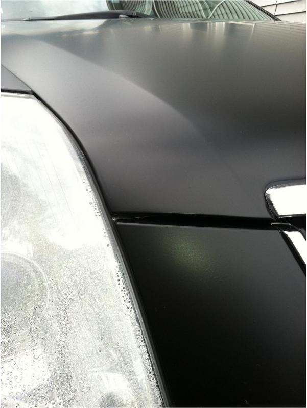

Looks nice. How was the 970RA to work with? I have been using 3M 1080 for all the matte black wraps I have done. It is easy to work with and lays down really nice. How much does the 970ra run? Looks really good.

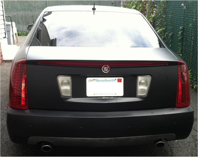

Looks good but is that vinyl lifting in the crease under the rear license plate or an 05 Caddy starting to rust away?
The rest looks very clean.

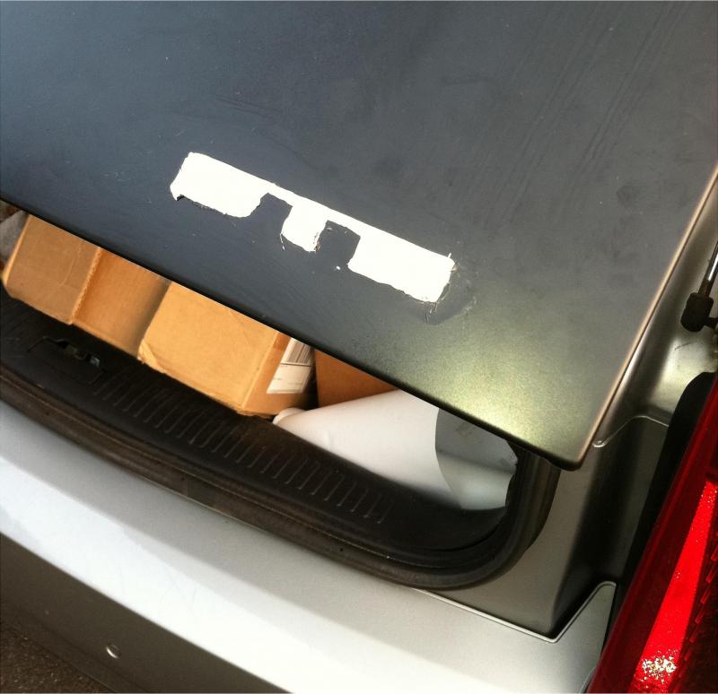

g&eprinting

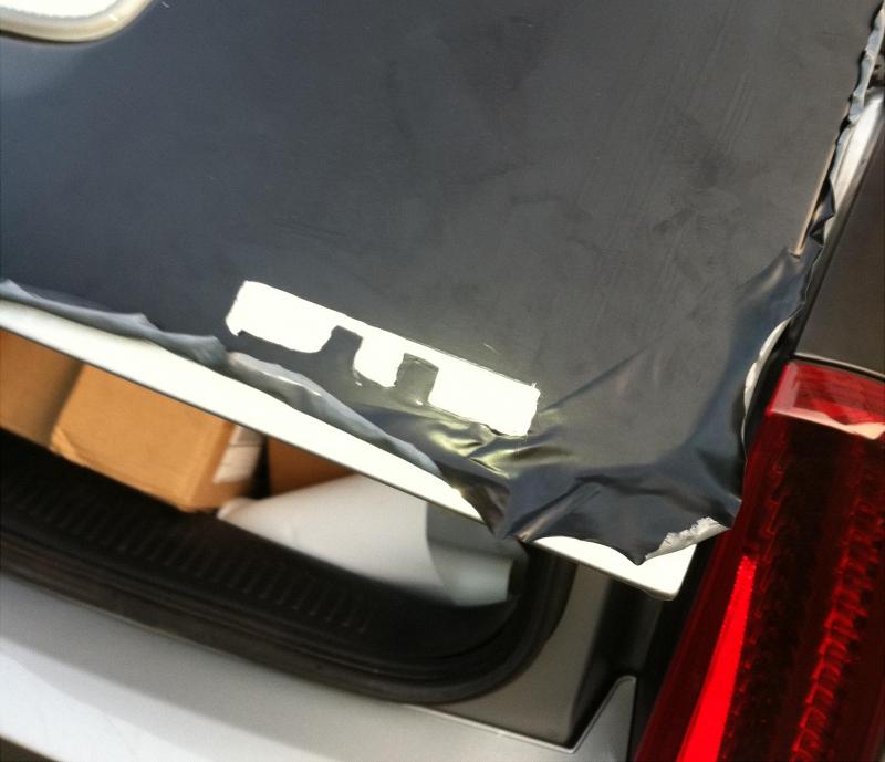

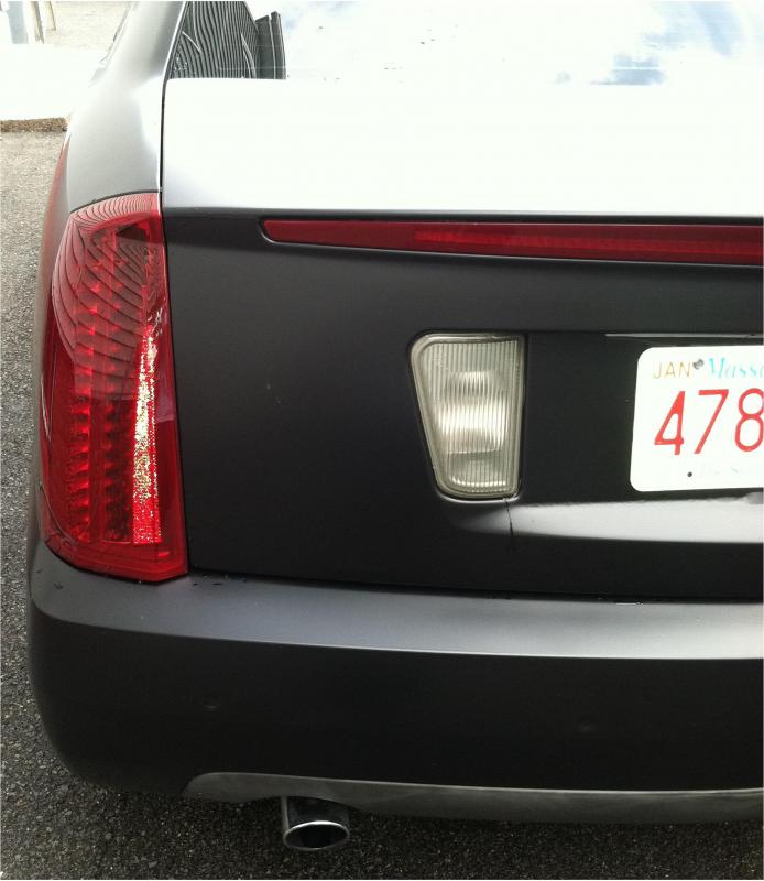

Yes it lifted.
That was the second round on that trunk. Took 3 to complete.
1st one was perfect and stretched then customer didn't want the STS symbol there anymore, so we cut around it at 1st, (no likey) then, removed it and re-wrapped.

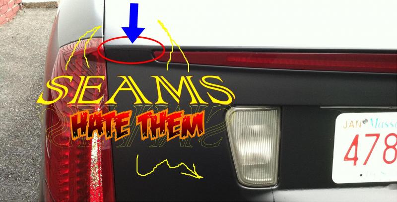

In the end I did a relief cut on the trunk above the license plate, below the symbol. Just where the light is below that overhang, which had to be cut anyway.
Which leads me to a question,,,,,???
When you have such an overhang of a trunk are you doing a relief cut or in separate pieces, (I hate seams) or stretching the whole trunk into place?
Some cars do not have such a large or long license plate light like this one???

Was very easy to use and easy to stretch. Felt much thicker than what I'm used to which was a little weird on door handles.
The glue seems to separate very easy from back so if you lay something down make sure it is correct the first time. If you need to pull a section up you might leave glue residue that is kind of thick behind which is a pain to remove.
Not looking forward to removing this at all.
While working when I cut off pieces sometimes I will put them on the car with no pressure just to hold while I'm working. Big NO NO with this!
Left glue residue anywhere I put a piece to hold on the car.
When stretching a bumper like I did on the rear, you could be 12 inches short on a cut and stretch that over 4 feet to make 5 feet with no gloss.
Heat entire length of 4 feet to make 5 feet in sections pretty nice stretch with no gloss.

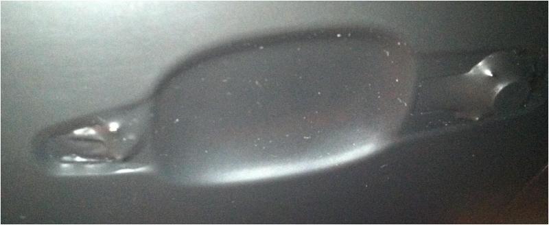

I wrapped my setpside pickup with the same film and in some places have the same problem with lifting. It just does not want to stay down in smallish but deep recesses. Larger recesses seem fine and yes - the adhesive separates from the film far too easy in my opinion.

Other than the license plate area, good job:thumb: on something like that license plate area, i usually go in and wrap it first and then put a seam all the way around it when i wrap the rest of the trunk. especially with 970ra. it just doesn't seem to do as good at staying in tight spots as good as other materials. you can put the seam in the right spot and it'll hide really well. it also makes it bullet proof. it's the same way i do door handle areas with deep recesses also.

Agreed 970ra doesn't like deep small concave surfaces.

Also saw some lifting on front bumper appearing on a not so concave area..:banghead: I notice not customer but I showed him.

Can you please post pictures of your seam placements... :notworthy::signs101:
