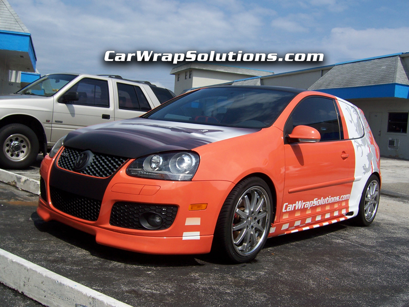

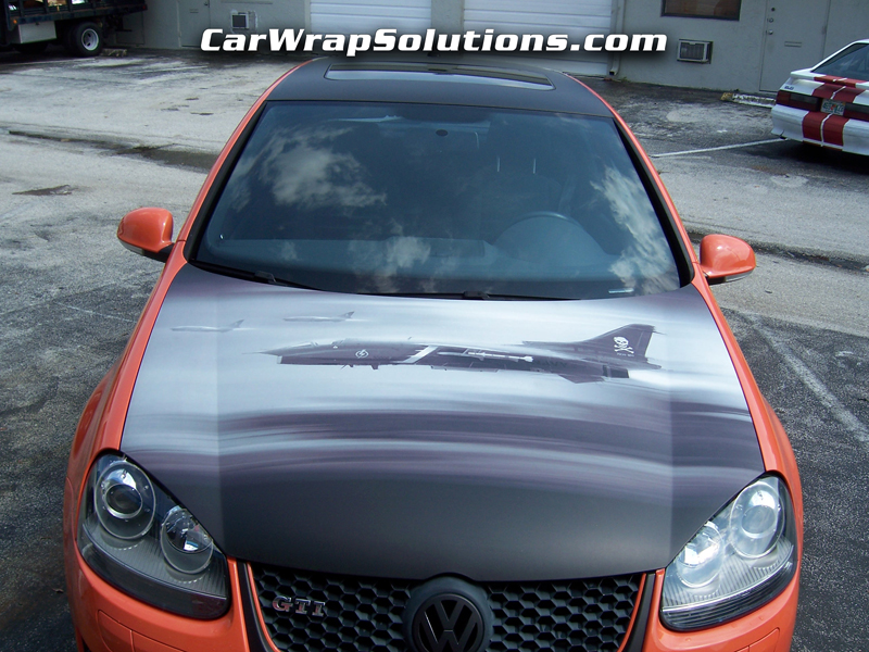

  • Volkswagen GTI vehicle wrap by Car Wrap Solutions in Ft Lauderdale, Florida, hood view, black ma.jpg
  • Volkswagen GTI vehicle wrap by Car Wrap Solutions.com in Ft Lauderdale, Florida, front corner vi.jpg
