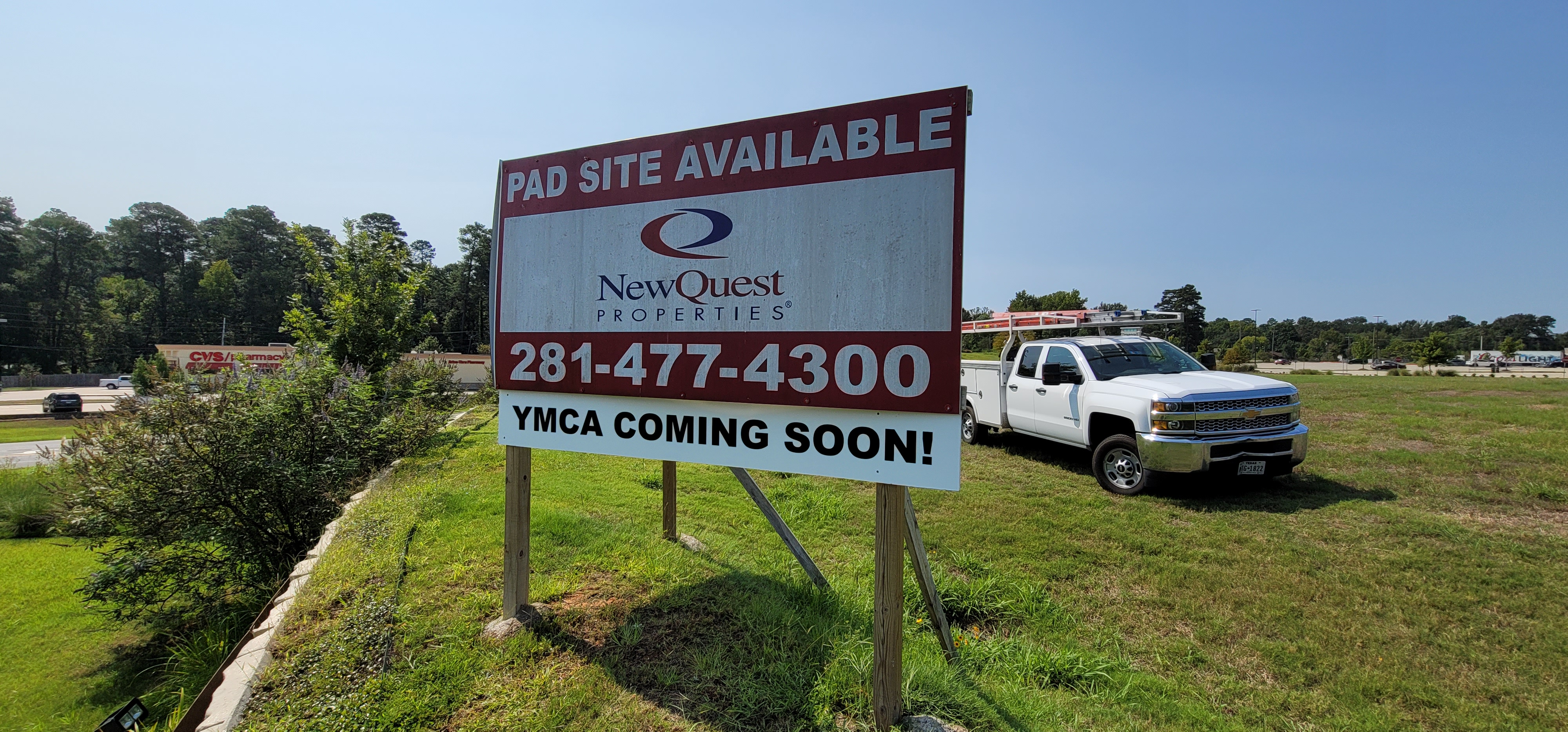

Few years ago I switch to mostly using matte overlam because I like the look of it better. I noticed a site-sign I did 2 years ago was dirty and moldy. Is gloss better for longevity or does it not matter?

Well, today I drove by a sign I did in gloss and noticed it was starting to get moldy too. I guess some areas are prone to mold more than others. I really prefer matte over gloss now, it doesn't glare outdoors or indoors and doesn't look as cheap.

Most of them are in East Texas / NE Louisiana... it's a hot muggy swamp so I guess it's no surprise. I haven't noticed it on building signs, just site signs.

It's not growing in between the two materials... it's on the surface. It can be cleaned away... this sign is just under 2 years old. Most signs don't look this bad after such a short time and I was thinking if it was because of the matte.
