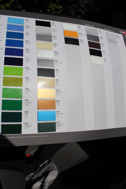

Oracal has a matte orange in their car wrap series, 970. I actually ordered a roll of this yesterday for my own car. It is called saffron yellow matte, but its a very orangey yellow. It is available in both regular 970 and 970RA with air release channel. Got this information confirmed yesterday by my supplier, cause the oracal website does not list this colour in 970RA, but they had it in stock in that series now. Ordered a roll of that.
If the 970 series is similar to the 975 (carbonfiber look) series vinyl to work with, then its a great vinyl for wrapping, have used quite a bit of that. A picture of a colour chart, reproduced on a monitor is a very bad way to show a colour, but anyway here is a pic, its the orangey colour named 223:

cool! thanks a lot, I probably wwill buy matte white first thougth yo do my car and my mechanics.
