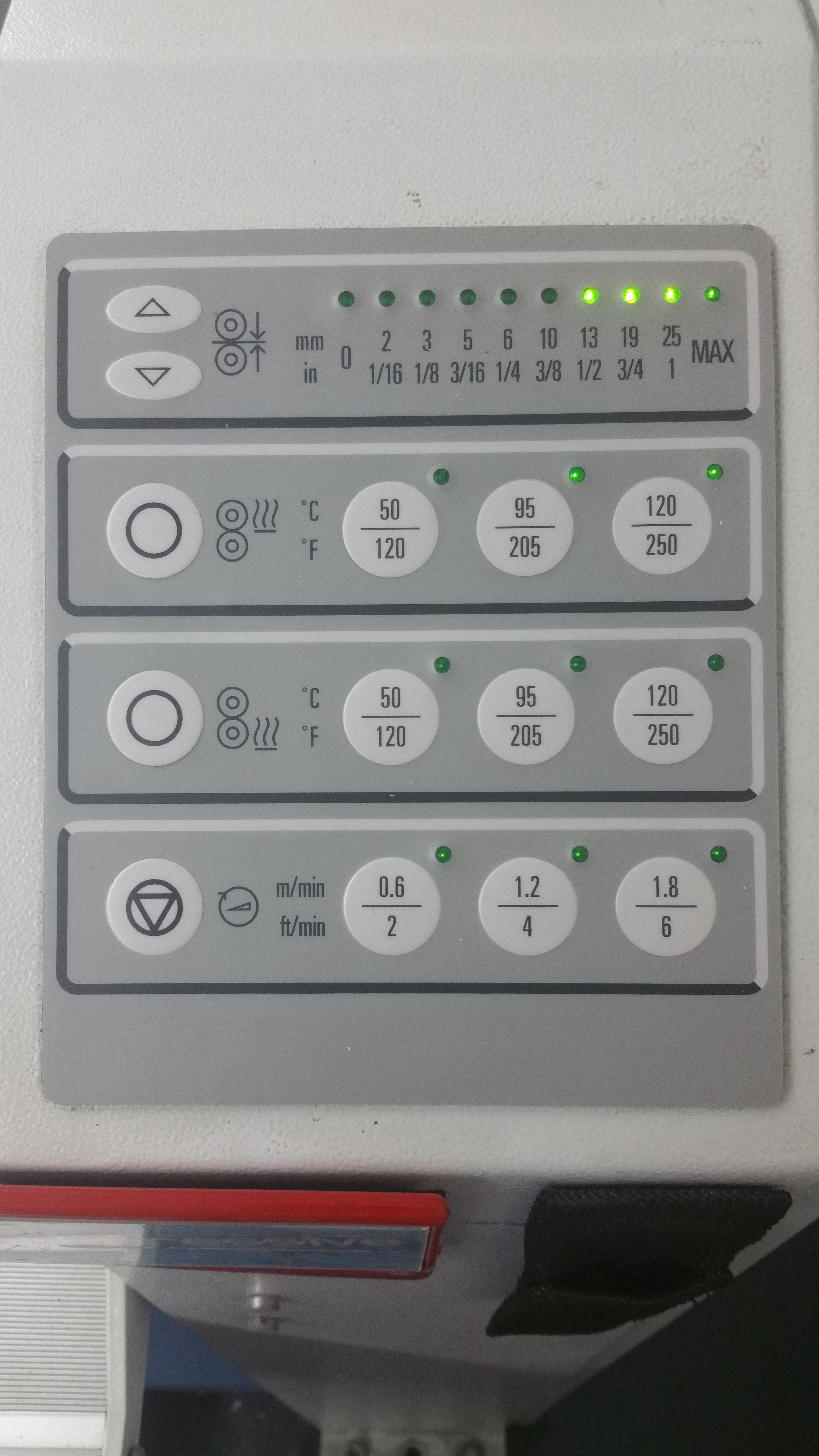

Hello,
I came across your post with your Seal laminator error and I am experiencing the same issue. Stopped half way into a print and now no other function is allowed. The control panel has other lights that are on constantly. Was wondering if your panel did the same thing and/or if you were able to fix your issue. Any help would be greatly appreciated!
Attached is an image of how it currently displays.
Thanks,
Yano

For those that have this issue in the future, my problem is exactly what OP describes. I was running a roll, my laminate ran out, when the laminator was untaping the last bit of laminate from the core(it ran out). The laminator stopped. Nothing would happen except a beep when I press the foot pedal. The light above max was flashing.
I was lucky to have some experience with machines and being the one to witness the machine fault.
The fuse blew when the roller motor overloaded from pulling the laminate off the core.
The fuses are glass tube fuses located on the board in black tube fuse holders. My motor fuse was a F2AL250V.
I have ordered one from Amazon.
I will confirm this fixes the problem, but I’m 99% certain it will at the moment.
