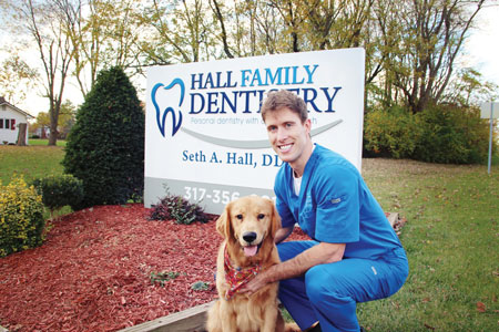

What kind of project is it? temporary or permanent.
It's permanent. He wants something like the attached picture.

If you wanna use MDO, I think the largest normally is 4' x 10' I've heard of some people carrying 5' x 10', but that's rare. You'll hafta either piece it together or go to polycarb.
If you go with 4' x 10', that just one seam down the middle, per sign. Certainly that will work for most applications.

You can do 2 sheets of MDO and overlay a 6' x 10' sheet of ACM not only will you not have a seem but it will be a finished face. We would use a 6' x 10' x .125 aluminum sheet and weld or glue a frame to the back along with your posts.
Going that way is gonna add quite a bit of cost just to get rid of a seam, that probably won't be seen from 20 feet away, anyhow. It's also gonna make it a little heavy (ugh) and tough to transport. :peace!:

This is how I would design it...
So, you wanna make a 72" x 120" sign using expensive MDO and then attach 3mm aluminum ACM to both sides to do away with a seam. Why not just start out with regular plywood and try to save some costs ?? Also, the largest I can find is 66", not 72". Over the years, we've used quite a bit of 66" x 151", but never 72". Are you sure of those measurements ??

To the OP...
I assume you work for a sign company with aluminum fabrication and finishing capabilities. If so, MDO face would not be my go to substrate on a permanent sign sitting on the ground.
