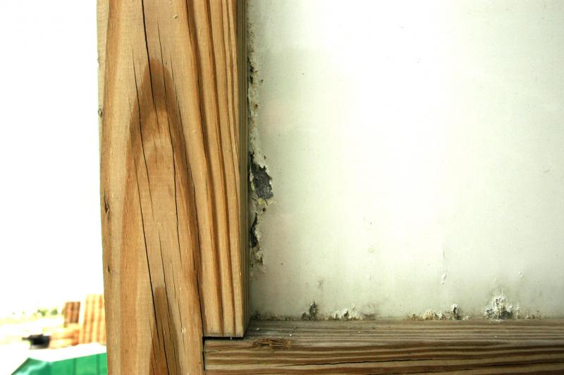

I use Gorrilla or Elmers equiv. glue and edge trim edges. Make sure you watch out for oozing. Sealing is critical especially if using treated lumber.
(See thread in tips)
