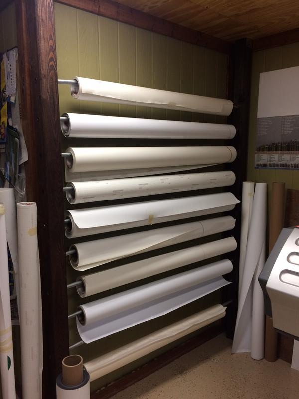

This is one we built using 4x4 posts and 1/2" rigid Electrical conduit.:rock-n-roll:

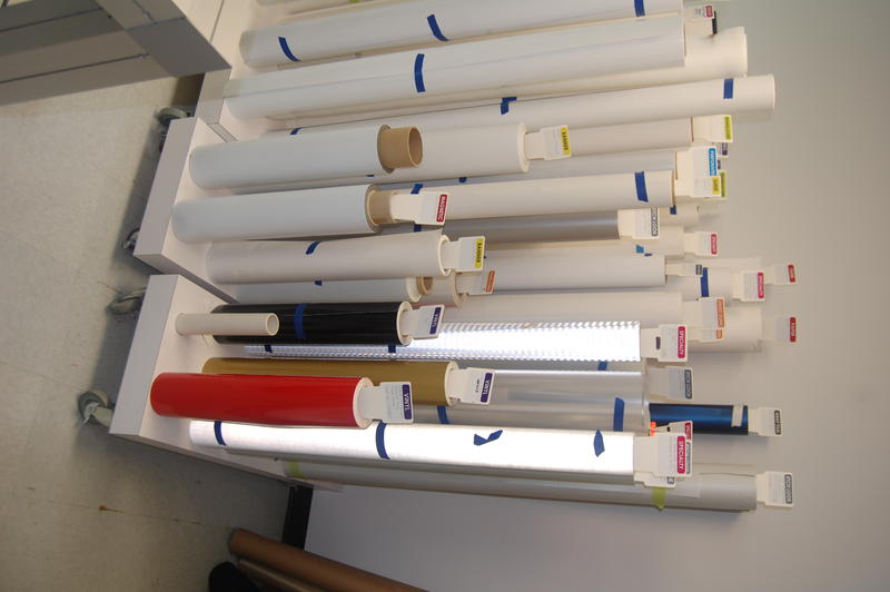

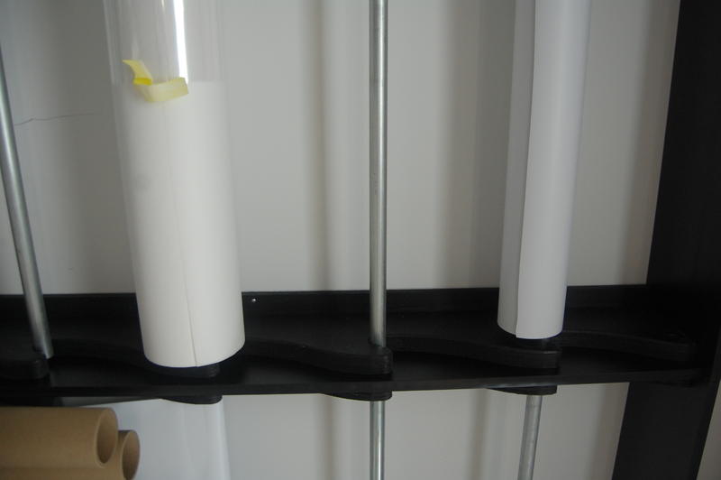

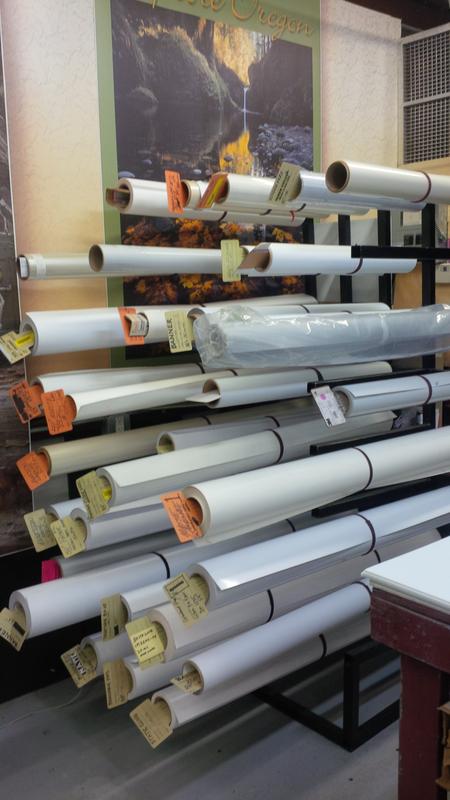

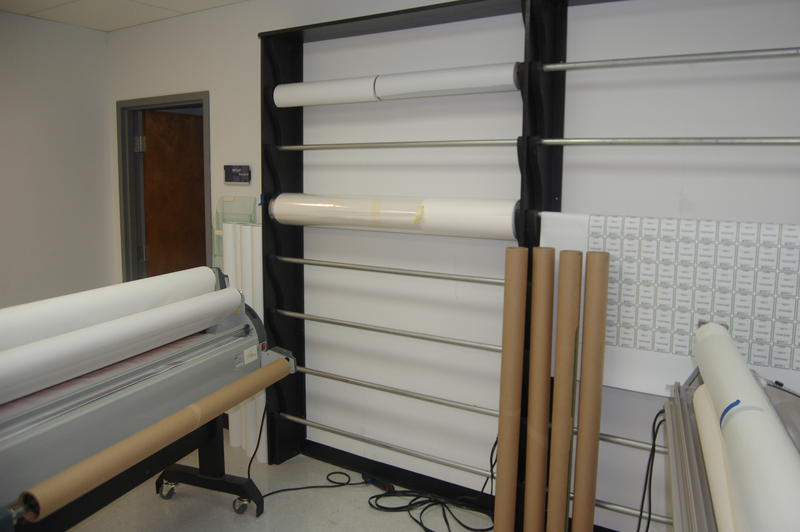

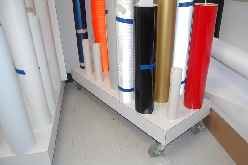

We have a couple of different material racks that we designed in-house. I do like how Devon's system works but would be concerned about how to secure the rods to be strong enough when sliding the material to one side to get the roll off. It obviously works well for him so I'm sure he's figured that part out. We have rolling racks with casters and PVC pipe that we can slide the rolls onto, as well as wall mounted "Gun Rack" material racks that work well also.

Devon19515
We used 4"x4" pressuretreated posts and drilled holes all the way through for the 1/2" Rigid EMT.
The hole was just big enough that we had to hammer the pipe in.
Devon19515
How long you make the rods:) ?
The pipes on the left are 10" long with 6" protruding from post, the ones on right are 14" with 10" protruding.
The gap between the ends of the pipes is about 45". I am able to slide the end of a 54" roll onto the longer pipe and have a 1" space to place it onto the second pipe.
