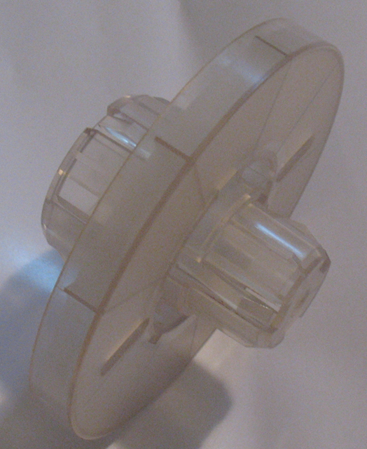

sfr table hockey
This is what you are looking for?
This one from the CJ 500 has a 1 3/8" ID.
Yes, Roland can't find a part number for these for my CJ-60. Are these generally all the same diameter inside? Could I take one from another machine and use it on my CJ-60?

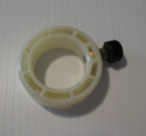

sfr table hockey
These would be more helpful and are in stock at our Georgia office
http://www.cssignsupply.com/index.php?dispatch=products.view&product_id=500
Bobby, do those just have friction fit or do they tighten inside the core to hold on tighter? If they tighten and actually hold 80 lbs, yes much better, and I might look at getting a set. Was that price for the set? How much to mail to Alberta?
As for the collar, those can be made either with wood or a couple of PVC pipe if you get the ID right.
jmmccann, is your roller bar 1 3/8" diameter?
Yes, the roller bar I believe is 1 3/8.
I was thinking about wood or PVC pipe. Any thoughts on that?
sfr table hockey
If you have a 1 3/8" hole cutter wood would be easiest. The outer cut could be rough and not matter if it's round. Outer cut could be done on a band saw or with a jig saw etc. You may be able to tapp threads in the wood or use a nut set in place (inside the walls of the ring) to thread through for the tightening screw.
sfr table hockey
To answer my own question in case others want to know, these flanges do have a knob to tighten and a rubber seal exspands in the core to hold tighter. They seem to work well. They are priced by the each so a set up here was $80.
