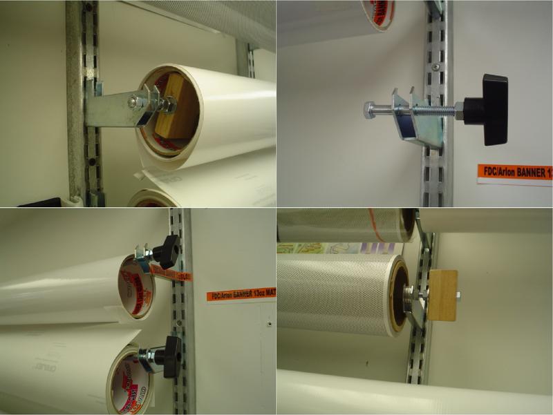

Gene@mpls
Here is the cheep mans version.
